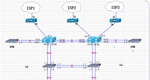

Hello everyone, our customer's topology environment as shown. I found that the GTM did not add the LC as a bigip type server, but instead added it as generic-host, so you can't use the auto discovery feature. Therefore, every time a new application is released, after creating a new VS on the LC, it needs to be re-added on the GTM. This is more troublesome. I don’t know why the engineer was designed like this. What are the benefits of this design? No firewall or address translation in GTM and LC。 And there is no LINK found on GTM? Is there a link on the LC, is the LINK on the GTM optional?
Now customers think about changing to bigip server, using auto discovery function, will direct modification affect the virtual server on the previous GTM?

  • The LC device is F5 LTM. The Data center has been created on the GTM, and the generic-host LC server has been created. Many virtual servers have been created under the server. Now if you change the LC server type from generic-host to bigip type, it will affect the virtual server already built, because the automatically discovered virtual server will conflict with the previous manual. If I want to change the server type, do I have to delete both the previous server and the virtual server.
  • You can create new servers in the same datacenter. However, you will have to manually replace the old manually creatwd virtuals with the new ones in each gtm pool. After that you can delete the old generic hosts.
  • Okay thank you. Ask another question, the customer only has only one data center physically, and three Datacenters are logically established according to the three ISPs, and Link is not configured. Is there any advantage to configuring the LC as a generic-host server? In fact, I want to know why engineers originally designed this way.
  • No, there is no advantage that I can think of to configure an F5 LTM as a generic host. It just gives you less visibility and poorer healthchecks. It is fine/necessary for non-F5 devices.
