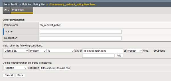

How do I perform a URL redirect on my traffic using F5 server?
I am setting up my very first F5 reverse proxy server and my first goal is to successfully redirect traffic from abc.mydomain.com to https://abc.mydomain.com.
I followed along with this YouTube tutorial, but the GUI was a bit different (an older version?).
In C:\Windows\System32\drivers\etc\hosts, I put in [my.server.ip.here abc.mydomain.com].
I suspect my rule isn't configured correctly. There may be other configuration issues as well.

      Unfortunately, that didn't work. My destination address on the virtual server is using service port 443 (https), so I tried that port as well, but haven't had any success.
  • Good afternoon,
    You need to configure two virtual servers.
    1 for http port 80 and 1 for https port 443
    The virtual server on port 80 will need an iRule that will do a redirect to 443 using a 301/302. Something along these lines:
    when HTTP_REQUEST {
    HTTP::respond 301 Location "https://[getfield [HTTP::host] : 1][HTTP::uri]"
