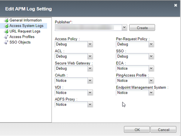

In our application we have a login method using certificates on mobile devices. There's something strange going on and I'm trying to find logs on how the access profile is run through. I've tried changing different settings and log levels but I might be looking in the wrong place.
Under System -> Logs -> Access Policy I can only find this:
Notice that the log level says 'notice' but I applied a custom logging profile to that access profile. The custom logging profile looks like this:
Is there anything I forgot to change in order to be able to see full debug logs for the access profile?

    Did you check the apm logging on the cli (tail -f /var/log/apm)? (or are you sending your debug log to an external logger? (can't see this in your screenshot, it is blurred out)).

    If you set "Access Profile" to debug you will be able to see all logs regarding path that you follow in the VPE... you set it right.
    Are you sure that you select your VPE in "Access Profile" menu? you have to select the Policy in the log profile...
    What's wrong, you wait to see what exactly and what is the behavior that you have?
