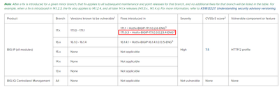

So I click to look into the items.  Very first item is "BIG-IP HTTP/2 vulnerability CVE-2023-40534".  I click into the article link to see what the fix is https://my.f5.com/manage/s/article/K000133467 and I can see that the fix is included in versions 17.1.0.3 + Hotfix-BIGIP-17.1.0.3.0.23.4-ENG and above.
I just recently upgraded from 17.1.0.3 Point Release 3 0.0.4 to 17.1.0.3 Engineering Hotfix 0.75.4 and according to the article "After a fix is introduced for a given minor branch, that fix applies to all subsequent maintenance and point releases for that branch" so why am I seeing this as a high priority fix to be applied?   Is my iHeath not showing me the correct information or am I just not reading it correctly?

      I suppose that's possible but it says right in the note above the table "After a fix is introduced for a given minor branch, that fix applies to all subsequent maintenance and point releases for that branch, and no additional fixes for that branch will be listed in the table. For example, when a fix is introduced in 14.1.2.3, the fix also applies to 14.1.2.4, and all later 14.1.x releases" which makes me believe that a fix in versions 17.1.0.3 + Hotfix-BIGIP-17.1.0.3.0.23.4-ENG would be included in 17.1.0.3 Engineering Hotfix 0.75.4.  I'll open up a ticket and ask.
