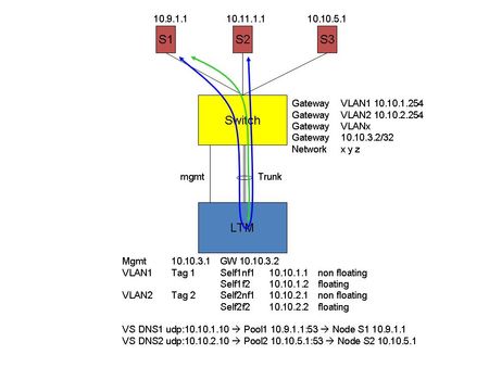

Hi,
I still was looking around the forum, but didn't found a solution for my problem.
Here is a little example picture:
We want to replace our old slb by a f5 ltm. It is a one ar...

Jun 17, 2015you have no route at the TMM level, but have one at the management. It will use this one, as the selfIPs are not in the same subnet as the pool member. You should define TMM routes (Network tab)
