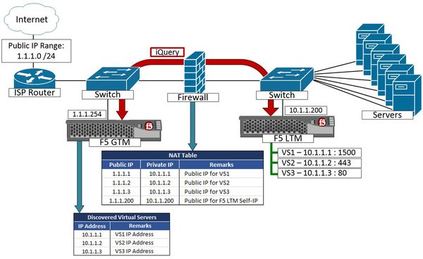

Scenario & Network Design Requirements:
- All Self-IPs and Virtual Servers on the F5 LTM must use private IP addresses and must not use public IP addresses
- For applications that are served via F5 LTM Virtual Servers which needs to be accessed over the internet, the public IP will be NAT-ed from an internet facing firewall to the private IP that is configured on the F5 LTM virtual server
- GTM will need to be able to monitor the status of Virtual Servers on the LTM using iQuery but when GTM responds to public DNS queries, GTM must return the public IP.
As you can see, we already have a problem here because the Virtual Server Discovery will populate the LTM Server Object on the GTM with all the Virtual Servers on the LTM but they're all configured with private IPs. You cannot link these virtual servers to Wide IP Pools and onwards to Wide IPs because then GTM will return private IPs when it receives DNS queries.

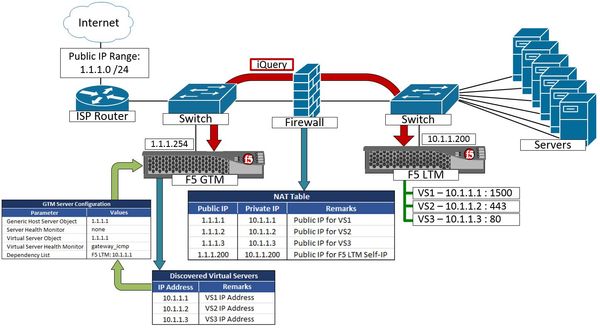

The solution that I came up with was to do this:
- Establish iQuery between the LTM and GTM and also enable Virtual Server Discovery
- Manually create Server objects of product Generic Host for each Virtual Server that needs to be reached over the internet, use the public IP that has been allocated by the Network Team which will be NAT-ed at the Firewall (eg. 1.1.1.1), do not apply any Health monitors, do not fill in the "Translation" field
- Manually create Virtual Server objects under the Server object created in 2 above, use the public IP that has been allocated by the Network Team which will be NAT-ed at the Firewall (eg. 1.1.1.1), switch the "Configuration" drop down menu to "Advanced", apply a simple gateway_icmp monitor, in the Dependency List - search for the actual virtual server which will accept the traffic (eg. 10.1.1.1), this virtual server would have been discovered earlier in 1 by Virtual Server Discovery.
This means the diagram now becomes like this:
When we do 3 above, what happens is that the GTM will ping the public NAT-ed IP of the Virtual Server (1.1.1.1), the firewall will NAT the IP to the private IP (10.1.1.1), the ping will reach the LTM Virtual Server and if the ping is successful, the object will be green on the GTM. This alone is not enough however as on the LTM, a "Standard" type virtual server will still respond to pings even if all the pool members are unavailable and the virtual server is also unavailable (this is where I think Virtual Server status as updated via iQuery is superior to a normal monitor), so to solve this problem I used the Dependency List option below the Health Monitor section and I chose the corresponding Virtual Server that was discovered by the Virtual Server Discovery (VS1 10.1.1.1).
This way, should all the pool members become unavailable on the LTM, the LTM will update the status of the virtual server to the GTM via iQuery and the GTM will make the 1.1.1.1 Virtual Server object unavailable even if the pings are still successful.
