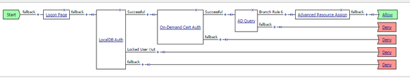

- pradeepkumar020
.... please tell me what i have to use in search filter as well as in branch rule..below is my VPE.... evry time am getting the error "" Following rule 'fallback' from item 'AD Query' to ending 'Deny' """
- Seth_Cooper
Employee
I wouldn't worry about the branch rule until you get the AD Query part working correctly. When you get the attributes returned from AD then you can make a decision on how to configure the rules. - pradeepkumar020
