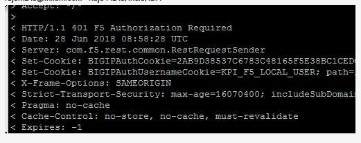

Getting 401 error while runnig script from rest APi after upgrade 12.1.3

If I recall correctly, you have to send an auth request for a token, based on the type of authentication you have configured, and then send that token as a header to authenticate the action you want to perform.
This link describes the process:
https://devcentral.f5.com/wiki/iControl.Authentication_with_the_F5_REST_API.ashx - Satoshi_Toyosa1Ret. Employee
You might have been using the RBAC (Role-Based Access Control) on your previous box. The settings do not survive upgrading. iControl REST User Guide for Version 11.6, pp. 22-23 tells you how to configure it. Having said so, for 12 and later, the recommended method is the Token Based Authentication just like ekaleido said above.
