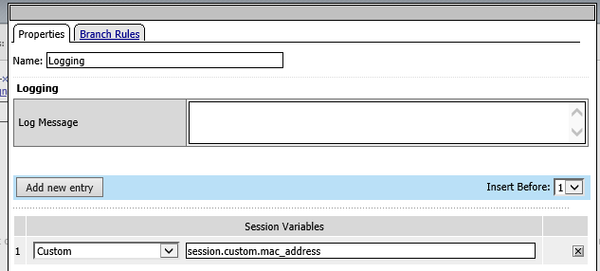

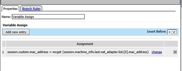

Here is what I have that does not seem to work.
Created a custom variable assignment
Then created a Log entry to capture the value of the variable in the session log
The variable gets created but is not populated. Do I need to specify the active adapter in the array in the expression for the variable assign?

you do have the Machine Info VPE element in your policy?
when you check the session variables, is there information there?
- JustinH
The variable is there but no information. Looked in the all the logs and nothing there on any errors.
- JustinH
Yes I have it. Just not inserted into the policy as I thought it was just for filtering on MAC address. I inserted it and left it blank this time. It worked! However this is not straight forward for just recording the MAC and not filtering on it. It does seem to initiate the check on the machine and not the expression in the variable assign alone.
