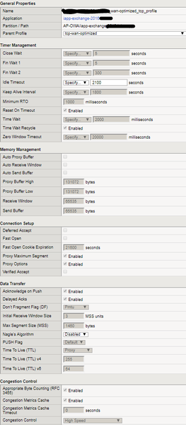

we just made the change from Exchange 2010 which was running on old Microsoft Forefront TMG to F5 iApp Exchange 2010 + 2016 with Load Balancing and Access Policy and everything else. It is still kind of "default" configured. I just have extended the Access Policy to make sure all customers from different WAN Locations and different domains can access to OWA etc.
Internal everything does work really fine. But external sources (like a Kindergarten want to Access OWA via the Town Hall infrastructure) are running reaaally slow. How can that be? I tried to research the problems.

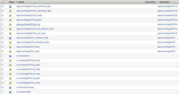

AP OWA: Deployed Exchange 2016 iApp
AP Server 1: 2010 LB with 2 Nodes, 2016 LB with 2 Nodes
AP Server 2: Virtual Server "Exchange redirect" with SNAT Auto Map (Is necessary for reaching the right network)

TCP Profile: Disable Nagle Algorithm, Disabled "Delayed Acks", Disabled "Slow Start"

Would be thankful for any idea! (Screenshots below: TCP Profile AP OWA, LB Virtual Servers AP Server 1)

  • which iApp did you use? there is no 2010 + 2016 one.
    if your setup works for 2010 and 2016 together then you run the 2016 one and they will proxy towards the 2010 ones. dont put 2010 and 2016 servers in one pool.
    where did you buy your F5? is there perhaps a F5 partner that can help?
    or if you have a support contract try to involve F5 support, as long as follow the iApp guide they should be able to guide you.
