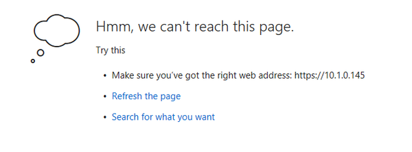

First time trying to configure F5 on WMware Workstation. Cannot https from my computer to the ip address I assigned it.
Hello, I am trying to finish the F5 configuration on my VMware Workstation, but when I try connect via browser it cannot reach it.

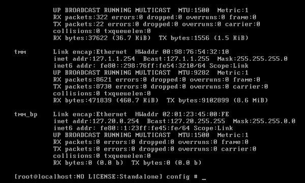

This is the output when I do ifconfig on the F5 VM:

You could run "ifconfig eth0" and check if MAC address, plus the subnet to the first "network adapter" on VMware BIG-IP machine settings, matches each other. Plus, check if your pc are connect to the same network as the BIG-IP.

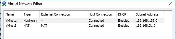

The VMnet1 i set to:

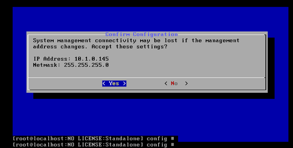

My intention was to connect via https to the BIG-IP, and then change it to the same subnet from there.
What would you change so I can ping or connect via https to 10.1.0.145?

Your VMnet1 isn't on 10.1.0.0/24. So, you need to put this subnet on VMnet1 or change the BIG-IP management ip address to 192.168.139.0/24 subnet.
