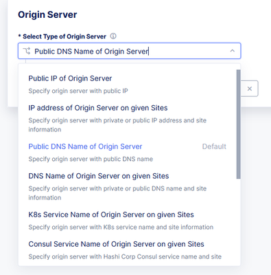

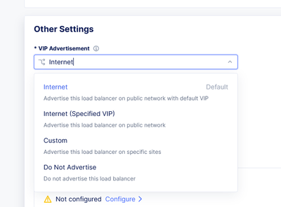

        As I mentioned better go through the F5 XC training for you to be able to narrow down the issue and then maybe to provide a more detailed info in the forum when the issue is complex and you can't solve it. The error for me suggests that maybe the issue is with your Customer Edge (CE) in some way as probably your Load Balancer or origin pool is on the CE not on the XC Global Cloud Regional Edge RE.
        Edit:
        This message cluster_not_found could be related to your CE cluster of 3 nodes but why it is not found when you mentioned that the CE is ok I can't tell.
  • Hello emircanbas  did found the issue ?
    Was it related with the XC CE cluster of 3 nodes not being available as I mentioned because of the error "cluster_not_found" and the LB being advertized on this CE cluster site or origin pool using this CE cluster site for discovering and connecting to the pool members ip address or public DNS (the origin pool seems more likely)?
