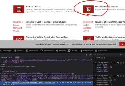

i am trying to configure https VS on F5 also the communication betwen VS and backend is with http
the issue that i have images not loading

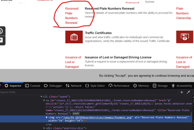

Did you look at the web page source to see how the URLs are written? Can you provide an example. In particular, how the image html tag src target is coded from the origin server. Once you have this, one can make a decision based on the issue -- fix on origin server, or have the F5 transform the src reference.
- AhmadJMay 26, 2023
Altocumulus
as you can see from above, the url for this service using https through F5 this image which is in the screenshot is .png and it is not loading but we have another image with same .png and loading fine
same issue with other extensions like svg
i tried to access the above by using the HTTP server URL directly and all working fine but with F5 it is not working
