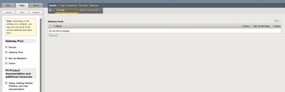

  • you can add Gateway Pool into HA setting.
    so if Node's GW pool status is down, it wont be Active node.
