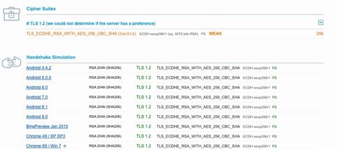

We currently have an SSL client profile with the following Ciphers setting:
ECDHE+HIGH:HIGH:!MD5:!EXPORT:!DES:!3DES:!DHE:!EDH:!RC4:!ADH:!SSLv3:!TLSv1:!TLSv1_1:!RSA
This results in "TLS_ECDHE_RSA_WITH_AES_256_CBC_SHA 0xc014 ECDH secp256r1 (eq. 3072 bits RSA) FS WEAK256" on ssllabs.com.
We need to disable all WEAK ciphers but are we limited due to lack of TLS 1.3 support here? Disabling 0xc014 (AES) would essentially deny all clients? Any help is greatly appreciated here.

  •  thank you for your reply. Looks like we will need to upgrade. With everything else turned off for a reason, ECDHE-RSA-AES256-CBC-SHA is the only suite we can offer now.

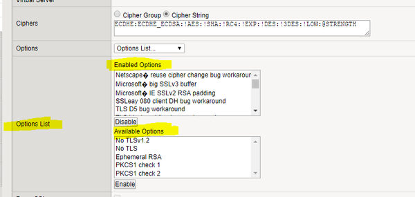

  • MEDIUM: ECDHE:ECDHE_ECDSA:!AES:!SHA:!RC4:!EXP:!DES:!3DES:!LOW:!SSLv2:!SSLv3:!TLSv1:!TLSv1_1:@STRENGTH
    Key size allowed 128-bit and 256-bit
    MAX: ECDHE:ECDHE_ECDSA:!AES:!SHA:!RC4:!EXP:!DES:!3DES:!MEDIUM:!LOW:!SSLv2:!SSLv3:!TLSv1:!TLSv1_1:@STRENGTH
    Key size allow 256-bit
    If you don’t want to block those ciphers on CBC then you can use the following string(s) below
    MEDIUM: ECDHE:ECDHE_ECDSA:!RC4:!EXP:!DES:!3DES:!LOW:!SSLv2:!SSLv3:!TLSv1:!TLSv1_1:@STRENGTH
    MAX: ECDHE:ECDHE_ECDSA:!RC4:!EXP:!DES:!3DES:!MEDIUM:!LOW:!SSLv2:!SSLv3:!TLSv1:!TLSv1_1:@STRENGTH
    Explanation
    • ECDHE - Allow Elliptic Curve Diffie-Hellman Ephemeral with RSA
    • ECDHE_ECDSA - Allow ECDHE with Elliptic Curve Digital Signature Algorithm
    • !AES - Block AES in CBC mode - 128-bit or 256-bit (needed to stop CBC ciphers)
    • !SHA - Block SHA/SHA1 (needed to stop CBC ciphers)
    • !RC4 - Block RC4 stream cipher
    • !EXP - Block Export grade ciphers- 40-bit or 56-bit
    • !DES - Block Single DES in CBC mode - 40-bit & 56-bit
    • !3DES - Block Triple DES in CBC mode - 168-bit
    • !LOW - Block Key size < 128bit
    • !MEDIUM - Block Key size <= 128bit (only 256-bit and higher remains)
    • !SSLv2 - Block SSLv2 Protocol
    • !SSLv3 - Block SSLv3 Protocol
    • !TLSv1 - Block TLS1.0 Protocol
    • !TLSv1_1 - Block TLS1.1 Protocol
    • @STRENGTH - Enforce most secure first
    Personally i did multiple changes for a project to stop TLS1.0 and TLS1.1 support but i find it more easy to not include those in the cipher string but in the options of the profile. Then you have a better overview and f you save this as a "template" you can re-assign it to your clientssl profiles and so you don't need to maintain all those individual but only the "parent". With the options to block CBC you will have a guaranteed A/A+ grade on SSL Labs. Keep in mind that Windows 7 clients with IE11 don't support GCM ciphers in combination with an RSA certificate! If you want to enforce GCM for Windows 7 and IE11 you need RSA AND ECDSA certificate in one client-ssl profile in order to let a client make an handshake with ECDHE_ECDSA.
