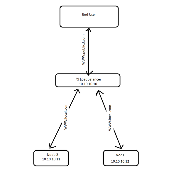

F5 load balancer bettween 2 BMC Action Request servers Error
Dears,
Hope you are doing well,
I'm trying to configure the F5 load balancer between 2 BMC Action Request servers,but i faced the "ARServer (********): ERROR (91): RPC call failed; ********:2020 ONC/RPC call timed out " Error , so any idea to do that please .
We did same things with this link https://docs.bmc.com/docs/ars91/en/f5-load-balancer-sample-configuration-609073435.html
Thanks
