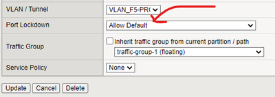

    If you are still looking for a simple way to have a unified entry point to always administrate the currently active cluster node, then adjust on one of your floating IPs the "Port Lockdown" setting to "Allow Default".
    Add a DNS Record to the Floating-IP and you finally achived what you've asked for...

  • psajdakl If you are using the management interface to connect to your F5 devices you do not really have an option to always connect to the active unit and it is up to the admin making the changes to make sure they are logged into the active unit. If you are using the self-IPs of the network interfaces you can use the method that Kai_Wilke has mentioned to always connect to the active unit. Now keep in mind that it doesn't really matter which device you make the change on because you can sync the configuration from the current F5 unit to the group which will sync the configuration to the active unit in the HA group. The only time it really matters what unit you are logging into is if the device you logged into is in a failed state or if you are troubleshooting communication through the F5s because that traffic through the F5s only occurs on the active unit.
