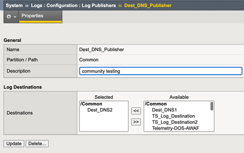

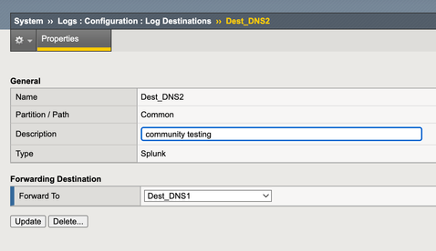

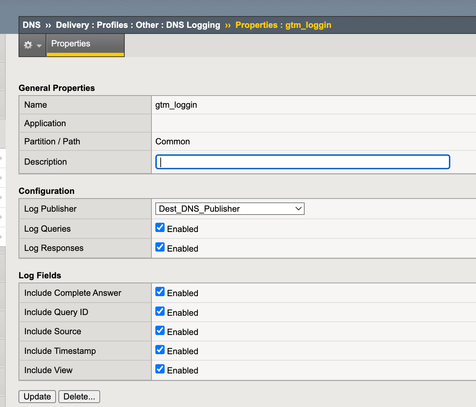

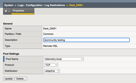

      I have configured DNS forwaridng as below:
      • Log Destination 1 using Remote HSL
      • Log Destination 2 for Splunk
      I then configured a Log Publisher with Destination 2 and updated the Logging Profile to use this Log Publisher.
      However, I am currently not receiving any data in my S3 bucket.
