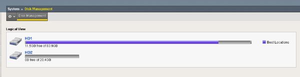

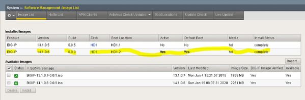

What could be the problem , attached couple of screenshot related to the problem ?
Whats the available size required for version 14.1.0.6 ? Just note that existing code is 13.1.0 and was trying to upgrade to 14.1.0
