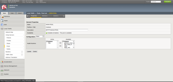

    • 0691T000008cjVbQAI.png0691T000008cjjiQAA.jpgHello  ,
      I have attached snaps here. It shows http profile and SNAT settings. Also 2nd snap shows statistics status under pool. If there are some numbers then it ,means requests are hitting F5 VS and F5 is forwarding requests to backend pool members.
      Hope it helps you!
