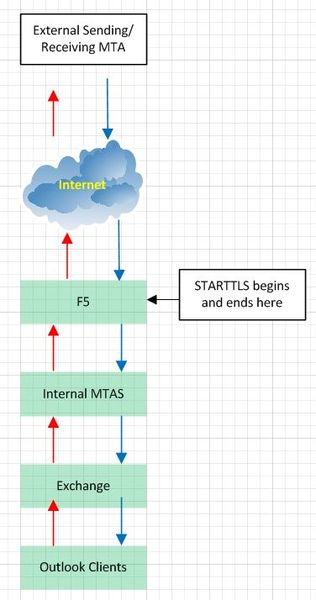

- Chuck76_338274
I don't know if this will help - but here is the concept. Thanks for the help.

- Chuck76_338274
After review we decided not to use the irule approach. We implemented TLS for email with the F5 listening for incoming email as opposed to initiating via the F5. The email gateways sending email outbound will initiate the TLS going out. The irule approach didn't seem to be a clean approach. We looked at it for a while. Thanks for following up.
