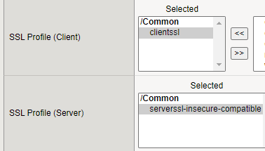

    Translate TLS version 1.0 to 1.2 is not possible, you have to break the SSL tunnel in the F5 to install the certificate of the application, to meet this requirement you have to:
    install the application certificate on the client-side for the virtual server create a SSL client-side profile, configure the virtual server with the client-side SSL created in the last step and configure the server-side with the default serverssl-insecure-compatible in the virtual server.
    https://support.f5.com/csp/article/K14620
    Hope it´s work.
