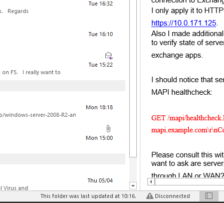

  • Hello Guys, this morning I am starting to deploy iApp template.
    About Exchange error - Outlook console stays disconnected.
    Outlook connection status console "status column" stays "connecting". And still MAPI healthcheck monitor(from guide) is not working. I think this is the key because https:///mapi is the link for outlook connections.

  • Hello,
    it's seems that your monitor don't Work. and therefore your requests to backend are forcibly blocked.
    From F5, can you please check backend health:
    Connect to F5 CLI, then enter this command
    curl -i -k https://1.1.1.2/mapi/healthcheck.htm -H "Host: mapi.domain.com"
    1.1.1.2 is one of your exchange backend and mapi.domain.com will be the fqdn of your mapi service.
