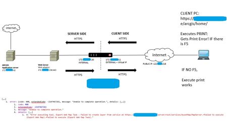

Yes I already did all the packet capture from Client to F5 and F5 to the DC-Switch where the web server is connected. We have also created a TAC case for this and worked with the support analyzing packets. But what we are missing right now is the packet capture on the web server itself, because client still not approving the installation of wireshark yet.
We are just using the built in devtool from Chrome, by pressing F12 to get the HAR files
But from what we have gathered and analyzed, print request requires "parameteres" in forms from the website. Comparing packets of with F5 and without F5, print request is the same, parameters are the same, so it made me think that there is nothing wrong with the request when passing F5, even it is performing "proxy" decrypt/encrypt process (ssl client / ssl server).
Sadly, even the Technical Support exhausted all possible tweaks, but still unable to resolve the problem,
I am reaching out now with ESRI the creator of ARCGIS, if there is a way to resolve this.

the website is totally working, just the print function is the problem.
