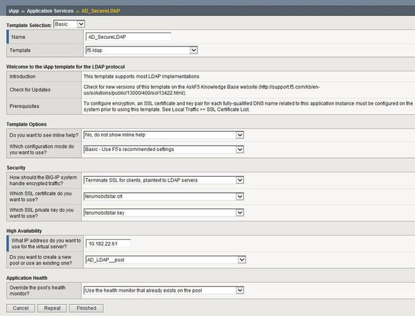

When running the built-in LDAP iApp on a cluster running 11.4.1 I receive the error below. I am creating a new LDAP/s virtual server where SSL is terminated on the F5, then plain text to the domain controllers. I have an existing regular LDAP pool with an existing LDAP monitor associated to it. I have the options in the new LDAP config use that existing pool and the same associated health monitor. This should be possible should it not?
Any help is appreciated.

  • Thanks for the replies. I was confident I could in fact run it fine if I created dedicated pools and monitors, but it seemed counter intuitive since the concept of pools should allow us to use more than one virtual server sharing a common pool.
    I looked at the output of that file and unfortunately it was less than enlightening:
    Starting iApp /Common/f5.ldap 04/29/2014 13:14:04
    create ltm persistence source-addr AD_SecureLDAP_source_address_persistence
    Starting iApp /Common/f5.ldap 04/29/2014 13:30:21
    Starting iApp /Common/f5.ldap 04/29/2014 13:32:04
  • mikeshimkus_111's avatar
    mikeshimkus_111
    Historic F5 Account
    Yes, that's unhelpful. Can you post the choices you made to produce the error, aside from the use existing pool/monitor ones?
  • Sure. I should note also that the original pool and monitor were not created from an iApp. They were created as part of a template when we were running on older 10.x code. Perhaps that is related, perhaps not.
    mikeshimkus_111
    Historic F5 Account
    So this is a box that was upgraded from v10? I am testing with the same choices in the iApp and not able to repro the error, so my guess is that it has something to do with the v10-created objects. Can you test if it still errors out with a new manually-created pool/monitor?
  • Yes, it must be related. I am able to complete the iApp if I choose to create a new pool and monitor. Odd. So, I have a couple duplicate objects doing the same thing now, but it does work. Thanks for the replies and assistance.
