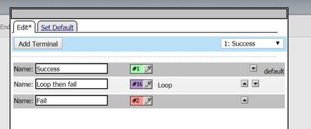

I am unable to delete the fail option in APM Macro. I saved the policy and again went to the VPE. Still there is no option to delete it.

6 years agoIn the 'Edit terminal' tab, After Changing the 'set default' tab of the macro, from 'Success' and 'Fail' and back again to 'Success'.
I am able to see the cross strike against fail . Clicking which will help me to remove 'fail'.
