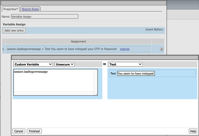

This configuration does apply to the whole access policy, so you'll have to get creative if you want the message to be different for different logon agents.
One way might be to use session variables. See how some of the message text boxes have stuff like %{session.whatever}? Those are APM session variables that you can write any data you want into. So write some text to a session variable right before your logon page agent, in a "variable assign", like this:
Then use that session variable in the text response customization, like this:
This way you can re-assign any text you like to that variable depending on your context.

Ah ok great sleuthing, sounds like you found the variable that contains your error: session.otp.verify.last.errmsg
So, all you have to do is set the text to be "Invalid Login. OTP error: %{session.otp.verify.last.errmsg}", and then when APM displays the error to the user, it will be dynamically generated from the authentication agent.
