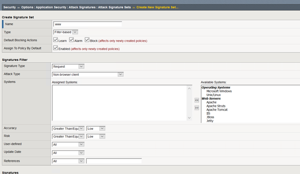

 I need to create Attack Signature Sets as shown in the figure below on the TMOS interface. What command can be used to achieve this.

  • TMOS is not possible but you can create ASM policy via JSON based script. This article will help you to create ASM/WAF policy.
    Thanks
  • You can use iControl REST API to create the custom signature set:
    https://support.f5.com/csp/article/K62654042
