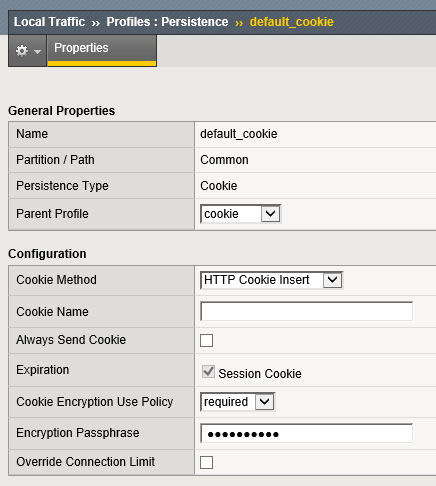

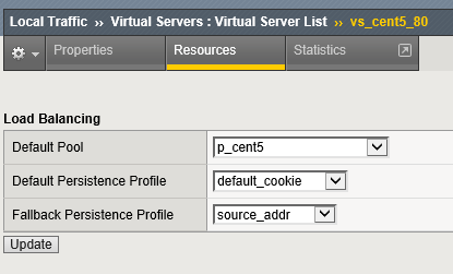

i set up persistence as bellow.

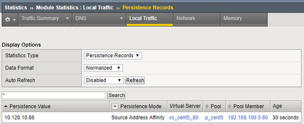

i can't see cookie on Persistence Mode item. you can see Source Address Affinity on Persistence Mode item.
  • i find that there is command related with cookie record.
root@(ltm_1)(cfg-sync Standalone)(Active)(/Common)(tmos) show ltm persistence persist-records mode
cookie all-properties Sys::Persistent Connections Total records returned: 0
Q) what is the reason i can't see cookie record on CLI and GUI. * cookie persistence setting
6 Replies
  • That is because cookie persistence doesn't use the persistence table. Look here for info on how the cookie is encoded.
