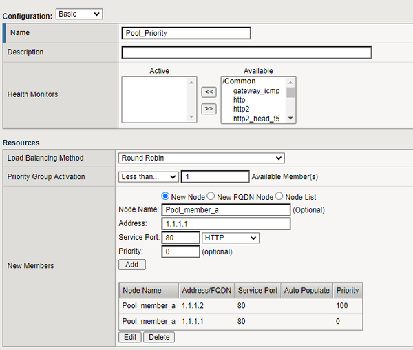

I have two sites (site-a and site-b with active/active setup). These are configured with two pool members(member-a 100 and member-b 0 as priority groups). I want to configure member-a with priority group 100 on both sites to make sure all traffic is routed to site-a though site-b is running. Is this possible?
1 Reply
  • Hi Mallik_Reddy,

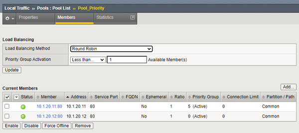

    At the pool level, you have to configure priority group activation set 100 to pool member a and set 0 to pool member b, and configure the priority group activation to Less than 1, this is a configuration example for a new pool member, but you can configure it inside the current pools:
    For a new pool:
    For existing pools:
