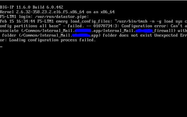

I brought down the standby node to add a new NIC for HA traffic but when I turned it back on I am now getting an error "Loading configuration process failed." When I try to log in to the web interface it is showing "Configuration utility restarting."
On the active device it is showing LTM-1 (the standby) as disconnected and I am unable to sync group to device. It seems to be looking for a folder that doesn't exist. Any assistance would be appreciated.

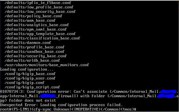

When I to tmsh load sys config, it gets to /config/bigip_script.conf then produces this error:
I think this was for an iApp that is no longer used and could most likely be removed if that is what is stalling the configuration. Which configs would need to be edited to stop this portion from loading?
