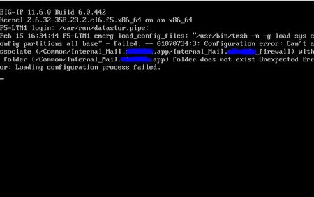

Feb 16, 2017Config won't load after adding NIC in HyperV
I brought down the standby node to add a new NIC for HA traffic but when I turned it back on I am now getting an error "Loading configuration process failed." When I try to log in to the web interfac...
bradss5_291679
Feb 16, 2017When I to tmsh load sys config, it gets to /config/bigip_script.conf then produces this error:
I think this was for an iApp that is no longer used and could most likely be removed if that is what is stalling the configuration. Which configs would need to be edited to stop this portion from loading?
