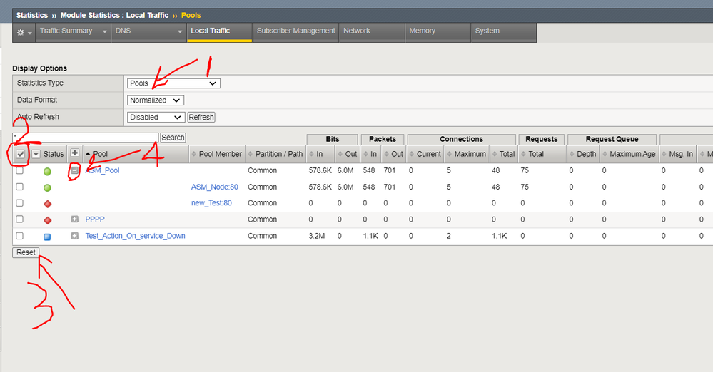

  • Hi davidy2001 ,
    Could you please change statistics types from nodes to pools , reset your statistics and expand your pool to see its members under it and try your tests again:
    such as this :
    Then , Share with me your results to see
