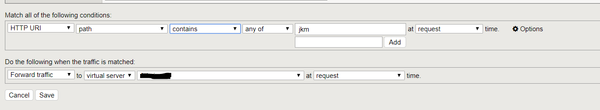

  • I will recommend you to use LTM policy to achieve your requirement. Please refer below.
    Hope it helps!

    • Mohd_Hazwan's avatar
      Mohd_Hazwan
      Hi,
      I already used this method but it didn't work
      Is this policy suitable for use in same fqdn but different server?

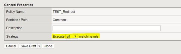

  • Hello,
    Please make few modifications in policy as given below. Once condition is matched (i.e. if uri ends with /ke), set redirect to the location where you want to point request to. e.g. https://10.10.10.10/ke . So request will be redirected to mentioned location.
    I tried this policy in my lab setup and it is working fine. Redirection is happening for only matched traffic. Please try same in your environment.
    Also just make sure, you have selected execute all matching rule under strategy (pls see below snap). So it will match all the rules written under policy.
    Hope it helps!
