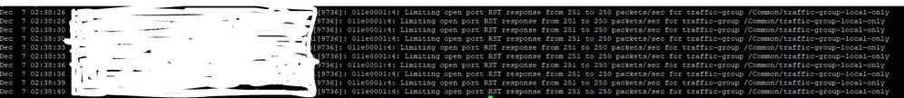

- sand87chDec 07, 2022
Cirrus
- Kai_WilkeDec 07, 2022
MVP
This means that your F5 is sending to much RST-Response because someone tried to access a non-existing service port on your F5.
Err Msg: 011e0001:4: Limiting open port RST response from 501 to 500 packets/sec (f5.com)
The only explanation for this would be, that your Pool got marked down so that your VS will be marked down too and your test still tries to access your VS (causing the system to send reset responses).
Can you please verify if your pool became unhealthy during your tests?
Cheers, Kai
