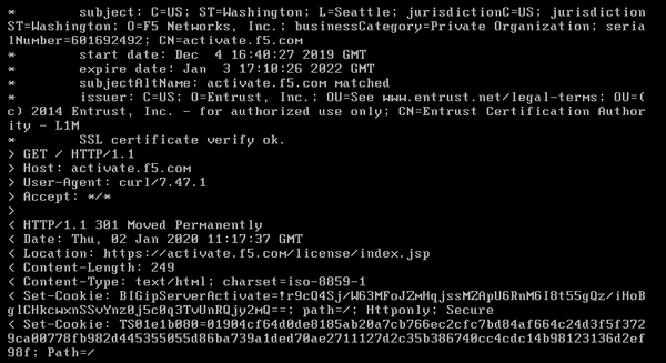

  • If I understand correctly, you are able to ping 8.8.8.8 from the BIG-IP? Can you share the output from the following command?
    # curl -v https://activate.f5.com

      • spyros's avatar
        spyros
        And yes I can ping 8.8.8.8 . The Vm can ping outside my local network.
