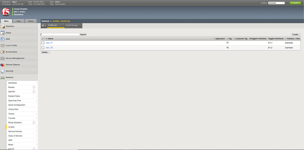

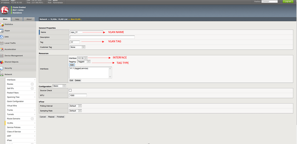

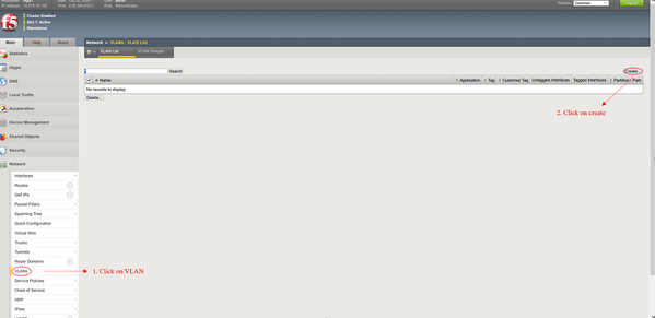

- On the Main tab, click Network > VLANs.
- Click on create.
3. Provide the following details on the VLAN creation page.
- VLAN Name
- VLAN Tag
- Interface Details
- Tag type - Tagged/Untagged
4. Similarly create another VLAN as mentioned in step 3.

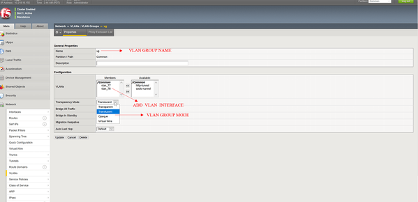

5. Click on VLAN groups to create a VLAN group.
6. Select VLAN interfaces and appropriate mode from the Transparency mode drop down.

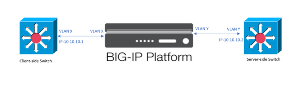

Opaque mode uses proxy ARP with Layer 3 forwarding. Proxy ARP occurs when one host is responding to an ARP request on behalf of another host. In opaque mode we need to configure self IP on VLAN group to forward the traffic.

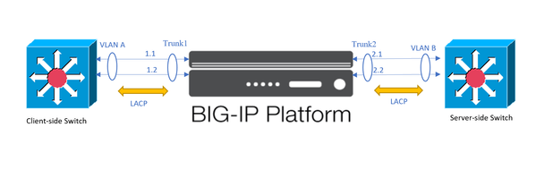

VLAN Group Trunk
In VLAN group deployment trunk can be configured in two LACP modes on BIGIP with neighboring devices . The two LACP mode are mentioned below
Active: Specifies that the BIGIP periodically sends control packets regardless of whether the partner system has issued a request.
Passive: Specifies that the BIGIP sends control packets only when the partner system has issued a request.

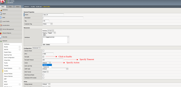

VLAN-based fail-safe:
VLAN fail-safe is a feature you enable when you want to base redundant-system failover on VLAN-related events. To configure VLAN fail-safe, you specify a timeout value and the action that you want the system to take when the timeout period expires.
Configure in CLI
tmsh create net vlan test1 {failsafe enabled failsafe-action reboot failsafe-timeout 90}
Configure in UI
1. Follow the steps mentioned above for creating VLAN.
2. In VLAN click on advance menu and enable the failsafe.
3. Also mention failsafe time out and failsafe action.
If the VLAN failsafe enabled link goes down, then BIGIP will wait for the failsafe timeout time and do a reboot or restart of BIGIP based on the failsafe action on a HA system. It is recommend to configure failsafe on HA system.

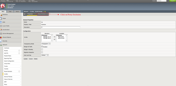

Proxy Exclusion List:
A host in a VLAN cannot normally communicate to a host in another VLAN. This rule applies to ARP requests as well. However, if you put the VLANs into a single VLAN group, the BIG-IP system can perform a proxy ARP request. The ARP request should be learned on member VLAN and not VLAN group
Proxy ARP request is an ARP request that the BIG-IP system can send, on behalf of a host in a VLAN, to hosts in another VLAN. A proxied ARP request requires that both VLANs belong to the same VLAN group.
In some cases, you might not want a host to forward proxied ARP requests to a specific host, or to other hosts in the configuration. To exclude specific hosts from receiving forwarded proxied ARP requests, specify the IP addresses in proxy exclusion list.
Configuring in CLI
tmsh modify net vlan-group vlt1001 proxy-excludes add {10.10.10.2}

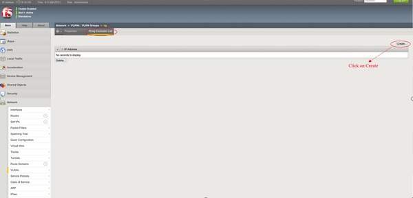

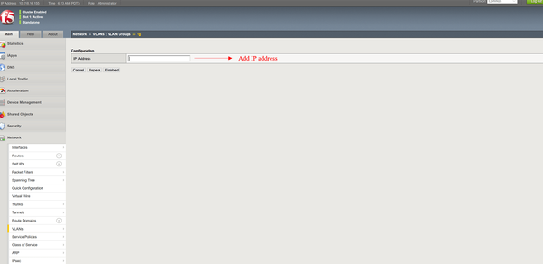

Configuring in UI
1. Follow the steps mention above as in mentioned in VLAN group configuration.
2. Click on proxy exclusion list.
3. Click on create button.
4. Add IP address which you want to block the ARP request.
5. Final config will look like below.

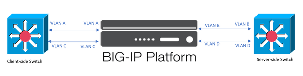

VLAN GROUP Asymmetric Deployment
When VLAN group is deployed in asymmetric way then network packets enter via VLAN AçèVLAN B and return via VLAN D & VLANC unlike symmetric path, in which packets come and go using the VLAN A and VLAN B.For the traffic to work in asymmetric path we need to disable db variable connection.vlankeyed.
Disabling VLAN-keyed connections
With VLAN-keyed connections enabled, the VLAN for the ingress traffic must match the configured VLAN and be present in the BIG-IP connflow lookup table, otherwise, the connection will not be processed by the BIG-IP system. This behavior is different for egress traffic, as egress traffic may use an alternate VLAN. For example, when a client sends SYN packets to a virtual server address configured on VLAN A, and that virtual server address replies to the connection request with a SYN/ACK from VLAN B, the ACK from that client will be matched when arriving on VLAN A or VLAN B. The BIG-IP system will not process the client's ACK reply if the reply arrives on a VLAN that is on VLAN C or VLAN D.
Disabling VLAN-keyed connections allows the BIG-IP system to accept asymmetrically routed connections across multiple VLANs.
