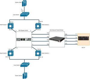

Introduction This article is part of a series on deploying BIG-IPs with bypass switches and network packet brokers. These devices allow for the transparent integration of network security tools with little to no network redesign and configuration change. For more information about bypass switch devices refer to https://en.wikipedia.org/wiki/Bypass_switch; for network packet brokers, refer to https://www.ixiacom.com/company/blog/network-packet-brokers-abcs-network-visibility and https://www.gigamon.com/campaigns/next-generation-network-packet-broker.html. The article series introduces network designs to forward traffic to the inline tools at layer 2 (L2). F5’s BIG-IP hardware appliances can be inserted in L2 networks. This can be achieved using either virtual Wire (vWire) or by bridging 2 Virtual LANs using a VLAN Groups. This document covers the design and implementation of the Gigamon Bypass Switch/Network Packet Broker in conjunction with the BIG-IP i5800 appliance and Virtual Wire (vWire). This document focuses on Gigamon Bypass Switch / Network Packet Broker. For more information about architecture overview of bypass switch and network packet broker refer to https://devcentral.f5.com/s/articles/L2-Deployment-of-vCMP-guest-with-Ixia-network-packet-broker?tab=series&page=1. Gigamon provides internal bypass switch within network packet broker device whereas Ixia has external bypass switch. Network Topology Below diagram is a representation of the actual lab network. This shows deployment of BIG-IP with Gigamon. Figure 1 - Topology before deployment of Gigamon and BIG-IP Figure 2 - Topology after deployment of Gigamon and BIG-IP Figure 3 - Connection between Gigamon and BIG-IP Hardware Specification Hardware used in this article are BIG-IP i5800 GigaVUE-HC1 Arista DCS-7010T-48 (all the four switches) Note: All the Interfaces/Ports are 1G speed Software Specification Software used in this article are BIG-IP 16.1.0 GigaVUE-OS 5.7.01 Arista 4.21.3F (North Switches) Arista 4.19.2F (South Switches) Gigamon Configuration In this lab, the Gigamon is configured with two type of ports, Inline Network and Inline Tool. Steps Summary Step 1 : Configure Port Type Step 2 : Configure Inline Network Bypass Pair Step 3 : Configure Inline Network Group (if applicable) Step 4 : Configure Inline Tool Pair Step 5 : Configure Inline Tool Group (if applicable) Step 6 : Configure Inline Traffic Flow Maps Step 1 : Configure Port Type First and Foremost step is to configure Ports. Figure 2 shows all the ports that are connected between Switches and Gigamon. Ports that are connected to switch should be configured as Inline Network Ports. As per Figure 2, find below Inline Network ports Inline Network ports: 1/1/x1, 1/1/x2, 1/1/x3, 1/1/x4, 1/1/x5. 1/1/x6, 1/1/x7, 1/1/x8 Figure 3 shows all the ports that are connected between BIG-IP and Gigamon. Ports that are connected to BIG-IP should be configured as Inline Tool Ports. As per Figure 3, find below Inline Tool ports Inline Tool ports: 1/1/x9, 1/1/x10, 1/1/x11, 1/1/x12, 1/1/g1, 1/1/g2, 1/1/g3, 1/1/g4 To configure Port Type, do the following Log into GigaVUE-HC1 GUI Select Ports -> Go to specific port and modify Port Type as Inline Network or Inline Tool Figure 4 - GUI configuration of Port Types Equivalent command for configuring Inline Network port and other port configuration port 1/1/x1 type inline-net port 1/1/x1 alias N-SW1-36 port 1/1/x1 params admin enable autoneg enable Equivalent command for configuring Inline Tool Port and other port configuration port 1/1/x9 type inline-tool port 1/1/x9 alias BIGIP-1.1 port 1/1/x9 params admin enable autoneg enable Step 2 : Configure Inline Network Bypass Pair Figure 1 shows direct connections between switches. An inline network bypass pair will ensure the same connections through Gigamon. An inline network is an arrangement of two ports of the inline-network type. The arrangement facilitates access to a bidirectional link between two networks (two far-end network devices) that need to be linked through an inline tool. As per Figure 2, find below Inline Network bypass pairs Inline Network bypass pair 1 : 1/1/x1 -> 1/1/x2 Inline Network bypass pair 2 : 1/1/x3 -> 1/1/x4 Inline Network bypass pair 3 : 1/1/x5 -> 1/1/x6 Inline Network bypass pair 4 : 1/1/x7 -> 1/1/x8 To configure the inline network bypass pair, do the following Log into GigaVUE-HC1 GUI Select Inline Bypass -> Inline Networks Figure 5 - Example GUI configuration of Inline Network Bypass Pair Equivalent command for configuring Inline Network Bypass Pair inline-network alias Bypass1 pair net-a 1/1/x1 and net-b 1/1/x2 physical-bypass disable traffic-path to-inline-tool Step 3 : Configure Inline Network Group An inline network group is an arrangement of multiple inline networks that share the same inline tool. To configure the inline network bypass group, do the following Log into GigaVUE-HC1 GUI Select Inline Bypass -> Inline Networks Groups Figure 6 - Example GUI configuration of Inline Network Bypass Group Equivalent command for configuring Inline Network Bypass Group inline-network-group alias Bypassgroup network-list Bypass1,Bypass2,Bypass3,Bypass4 Step 4 : Configure Inline Tool Pair Figure 3 shows connection between BIG-IP and Gigamon which will be in pairs. An inline tool consists of inline tool ports, always in pairs, running at the same speed, on the same medium. As per Figure 3, find below Inline Tool pairs. Inline Network bypass pair 1 : 1/1/x9 -> 1/1/x10 Inline Network bypass pair 2 : 1/1/x11 -> 1/1/x12 Inline Network bypass pair 3 : 1/1/g1 -> 1/1/g2 Inline Network bypass pair 4 : 1/1/g3 -> 1/1/g4 To configure the inline tool pair, do the following Log into GigaVUE-HC1 GUI Select Inline Bypass -> Inline Tools Figure 7 - Example GUI configuration of Inline Tool Pair Equivalent command for configuring Inline Tool pair inline-tool alias BIGIP1 pair tool-a 1/1/x9 and tool-b 1/1/x10 enable shared true Step 5 : Configure Inline Tool Group (if applicable) An inline tool group is an arrangement of multiple inline tools to which traffic is distributed to the inline tools based on hardware-calculated hash values. For example, if one tool goes down, traffic is redistributed to other tools in the group using hashing. To configure the inline tool group, do the following Log into GigaVUE-HC1 GUI Select Inline Bypass -> Inline Tool Groups Figure 8 - Example GUI configuration of Inline Tool Group Equivalent command for configuring Inline Tool Group inline-tool-group alias BIGIPgroup tool-list BIGIP1,BIGIP2,BIGIP3,BIGIP4 enable Step 6 : Configure Inline Traffic Flow Maps Flow mapping takes traffic from a network TAP or a SPAN/mirror port and sends it through a set of user-defined map rules to the tools and applications that secure, monitor and analyze IT infrastructure. As per Figure 2, it is the high-level process for configuring traffic to flow from the inline network links to the inline tool group, allowing you to test the deployment functionality of the BIG-IP appliances within the group. To configure the inline tool group, do the following Log into GigaVUE-HC1 GUI Select Maps -> New Figure 9 - Example GUI configuration of Flow Maps Note: Above configuration allows all traffic from Inline Network Group to flow through Inline Tool Group Equivalent command for configuring PASS ALL Flow Map map-passall alias Map1 to BIGIPgroup from Bypassgroup Flow Maps can be configured specific to certain traffic. For example, If LACP traffic should bypass BIG-IP and all other traffic should pass through BIG-IP. Find below command to achieve mentioned condition map alias inMap type inline byRule roles replace admin to owner_roles comment " " rule add pass ethertype 8809 to bypass from Bypassgroup exit map-scollector alias SCollector roles replace admin to owner_roles from Bypassgroup collector BIGIPgroup exit Note: For more details on Gigamon, refer https://docs.gigamon.com/pdfs/Content/Shared/5700-doclist.html BIG-IP Configuration In series of BIG-IP and Gigamon deployment, BIG-IP configured in L2 mode with Virtual Wire (vWire) Step Summary Step 1 : Configure interfaces to support vWire Step 2 : Configure trunk in LACP mode or passthrough mode Step 3 : Configure Virtual Wire Note: Steps mentioned above are specific to topology in Figure 2. For more details on Virtual Wire (vWire), refer https://devcentral.f5.com/s/articles/BIG-IP-vWire-Configuration?tab=series&page=1 and https://devcentral.f5.com/s/articles/vWire-Deployment-Configuration-and-Troubleshooting?tab=series&page=1 Step 1 : Configure interfaces to support vWire To configure interfaces to support vWire, do the following Log into BIG-IP GUI Select Network -> Interfaces -> Interface List Select Specific Interface and in vWire configuration, select Virtual Wire as Forwarding Mode Figure 10 - Example GUI configuration of interface to support vWire Step 2 : Configure trunk in LACP mode or passthrough mode To configure trunk, do the following Log into BIG-IP GUI Select Network -> Trunks Click Create to configure new Trunk. Enable LACP for LACP mode and disable LACP for LACP passthrough mode Figure 11 - Example GUI configuration of Trunk in LACP Mode Figure 12 - Example GUI configuration of Trunk in LACP Passthrough Mode As per Figure 2, when configured in LACP Mode, LACP will be established between BIG-IP and switches. When configured in LACP passthrough mode, LACP will be established between North and South Switches. As per Figure 2 and 3 , there will be four trunk configured as below, Left_Trunk 1 : Interfaces 1.1 and 2.3 Left_Trunk 2 : Interfaces 1.3 and 2.1 Right_Trunk 1 : Interfaces 1.2 and 2.4 Right_Trunk 2 : Interfaces 1.4 and 2.2 Left_Trunk ensure connectivity between BIG-IP and North Switches. Right_Trunk ensure connectivity between BIG-IP and South Switches. Note: Trunks can be configured for individual interfaces, if LACP passthrough configured as LACP frames not getting terminated at BIG-IP Step 3 : Configure Virtual Wire To configure trunk, do the following Log into BIG-IP GUI Select Network -> Virtual Wire Click Create to configure Virtual Wire Figure 13 - Example GUI configuration of Virtual Wire Above Virtual Wire configuration will work for both Tagged and Untagged traffic. Figure 2 and 3, requires both the Virtual Wire configured. This configuration works for both LACP mode and LACP passthrough mode. If each interface configured with specific trunk in passthrough deployment, then there will be 4 specific Virtual Wires configured. Note: In this series, all the mentioned scenarios and configuration will be covered in upcoming articles. Conclusion This deployment ensures transparent integration of network security tools with little to no network redesign and configuration change. The Merits of above network deployment are Increases reliability of Production link Inline devices can be upgraded or replaced without loss of the link Traffic can be shared between multiple tools Specific Traffic can be forwarded to customized tools Trusted Traffic can be Bypassed un-inspected3.2KViews9likes5CommentsBIG-IP vWire Configuration

Introduction This article is part of a series on deploying BIG-IPs with bypass switches and network packet brokers. These devices allow for the transparent integration of network security tools with little to no network redesign and configuration change. For more information about bypass switch devices refer to https://en.wikipedia.org/wiki/Bypass_switch; for network packet brokers, refer to https://www.ixiacom.com/company/blog/network-packet-brokers-abcs-network-visibility and https://www.gigamon.com/campaigns/next-generation-network-packet-broker.html. The article series introduces network designs to forward traffic to the inline tools at layer 2 (L2). F5’s BIG-IP hardware appliances can be inserted in L2 networks. This can be achieved using either virtual Wire (vWire) or by bridging 2 Virtual LANs using a VLAN Groups. This document covers the design and implementation of the IXIA Bypass Switch/Network Packet Broker in conjunction with the BIG-IP i5800 appliance and Virtual Wire (vWire). This document focuses on IXIA Bypass Switch / Network Packet Broker. For more information about architecture overview of bypass switch and network packet broker refer to https://devcentral.f5.com/s/articles/L2-Deployment-of-vCMP-guest-with-Ixia-network-packet-broker?tab=series&page=1. This article focuses on Active / Standby configuration of Inline Tool Port Pairs in IXIA NPB Network Topology Below diagram is a representation of the actual lab network. This shows deployment of BIG-IP with IXIA Bypass Switch and Network Packet Broker. Figure 1 - Deployment of BIG-IP with IXIA Bypass Switch and Network Packet Broker Please refer Lab Overview section in https://devcentral.f5.com/s/articles/BIG-IP-L2-Deployment-with-Bypasss-Network-Packet-Broker-and-LACP?tab=series&page=1 for more insights on lab topology and connections. Hardware Specification Hardware used in this article are IXIA iBypass DUO ( Bypass Switch) IXIA Vision E40 (Network Packet Broker) BIG-IP Arista DCS-7010T-48 (all the four switches) Software Specification Software used in this article are BIG-IP 16.1.0 IXIA iBypass DUO 1.4.1 IXIA Vision E40 5.9.1.8 Arista 4.21.3F (North Switches) Arista 4.19.2F (South Switches) Switch and Ixia iBypass Duo Configuration Switch and IXIA iBypass configurations are same as mentioned in below article https://devcentral.f5.com/s/articles/BIG-IP-L2-Virtual-Wire-LACP-Passthrough-Deployment-with-IXIA-Bypass-Switch-and-Network-Packet-Broker-I IXIA Vision E40 Configuration Most of the configurations are same as mentioned in https://devcentral.f5.com/s/articles/BIG-IP-L2-Virtual-Wire-LACP-Passthrough-Deployment-with-IXIA-Bypass-Switch-and-Network-Packet-Broker-I. In this article Inline Tool Port pairs are configured as Active/ Standby in Tool Resources as below Figure 2 - Configuration of Tool Resources Here BIG IP1 Inline Tool Port Pair is Active and BIG IP2 Inline Tool Port Pair is Standby. Traffic will be passing through BIG IP1 Inline Tool Port Pair initially and once it is down then BIG IP2 will become active BIG-IP Configuration Most of the configurations are same as mentioned in https://devcentral.f5.com/s/articles/BIG-IP-L2-Virtual-Wire-LACP-Passthrough-Deployment-with-IXIA-Bypass-Switch-and-Network-Packet-Broker-I. In this article, vWire is configured with Links State Propagation disabled as below Figure 3 - Configuration of Virtual Wire Note: As we covered Propagate Virtual Wire Link Status enabled in previous article, here plan is to disable Propagate Virtual Wire Link Status and test the scenarios. Both the Enabling and disabling of Link state Propagation work for both Active / Active and Active / Standby configuration of Inline Tool Port Pair in NPB. Scenarios As LACP passthrough mode configured in BIG-IP, LACP frames will passthrough BIG-IP. LACP will be established between North and South Switches. ICMP traffic is used to represent network traffic from the north switches to the south switches. Scenario 1: Traffic flow through BIG-IP with North and South Switches configured in LACP active mode Above configurations shows that all the four switches are configured with LACP active mode. Figure 4 - MLAG after deployment of BIG-IP and IXIA with Switches configured in LACP ACTIVE mode Figure 4 shows that port-channels 513 is active at both North Switches and South Switches. Figure 5 - ICMP traffic flow from client to server through BIG-IP Figure 5 shows ICMP is reachable from client to server through BIG-IP. This verifies test case 1, LACP getting established between Switches and traffic passthrough BIG-IP successfully. Scenario 2: Active BIG-IP link goes down with link state propagation disabled in BIG-IP Figure 3 shows Propagate Virtual Wire Link Status enabled in BIG-IP. Figure 5 shows that interface 1.1 of BIG-IP is active incoming interface and interface 1.4 of BIG-IP is active outgoing interface. Disabling BIG-IP interface 1.1 will make active link down as below Figure 6 - BIG-IP interface 1.1 disabled Figure 7 - Trunk state after BIG-IP interface 1.1 disabled Figure 7 shows that the trunks are up even though interface 1.1 is down. As per configuration, North_Trunk has 2 interfaces connected to it 1.1 and 1.3 and one of the interface is still up, so North_Trunk status is active. Figure 8 - MLAG status with interface 1.1 down and Link State Propagation disabled Figure 8 shows that port-channel 513 is active at both North Switches and South Switches. This shows that switches are not aware of link failure and it is been handled by IXIA configuration. Figure 9 - IXIA Bypass Switch after 1.1 interface of BIG-IP goes down As Single Service Chain is configured and which will be down only if both Inline Tool Port pairs are down in NPB. So Bypass will be enabled only if Service Chain goes down in NPB. Figure 9 shows that still Bypass is not enabled in IXIA Bypass Switch. Figure 10 - Service Chain and Inline Tool Port Pair status in IXIA Vision E40 ( NPB ) Figure 10 shows that Service Chain is still up as BIG IP2 ( Inline Tool Port Pair ) is active whereas BIG IP1 is down. Figure 1 shows that P09 of NPB is connected 1.1 of BIG-IP which is down. As Tool Status of active Inline Tool Port Pair is offline, Standby will become active. Figure 11 - ICMP traffic flow from client to server through BIG-IP Figure 11 shows that still traffic flows through BIG-IP even though 1.1 interface of BIG-IP is down. Now active incoming interface is 1.3 and active outgoing interface is 1.4. Low bandwidth traffic is still allowed through BIG-IP as bypass not enabled and IXIA handles rate limit process. Scenario 3: When North_Trunk goes down with link state propagation enabled in BIG-IP Figure 12 - BIG-IP interfaces 1.1 and 1.3 disabled Figure 13 - Trunk state after BIG-IP interfaces 1.1 and 1.3 disabled As Propagate Virtual Wire Link State disabled, only North_Trunk is down. Figure 14 - IXIA Bypass Switch after 1.1 and 1.3 interfaces of BIG-IP goes down Figure 15 - ICMP traffic flow from client to server bypassing BIG-IP Conclusion This article covers BIG-IP L2 Virtual Wire Passthrough deployment with IXIA. IXIA configured using Single Service Chain and Tool Resource configured with Active/Standby of Inline Tool Port Pairs. Observations of this deployment are as below VLAN Translation in IXIA NPB will convert real VLAN ID (513) to Translated VLAN ID (2001 and 2002) BIG-IP will receive packets with translated VLAN ID (2001 and 2002) VLAN Translation needs all packets to be tagged, untagged packets will be dropped. LACP frames are untagged and thus bypass configured in NPB for LACP. Tool Sharing needs to be enabled for allowing untagged packet which will add extra tag. This type of configuration and testing will be covered in upcoming articles. With Single Service Chain, If any one of the Inline Tool Port Pairs goes down, low bandwidth traffic will be still allowed to pass through BIG-IP (tool) If any of the Inline Tool link goes down, IXIA handles whether to bypass or rate limit. Switches will be still unaware of the changes. With Single Service Chain, if Tool resource configured with Inline Tool Port pairs in Active - Standby state then primary Port Pair will be active and if Primary Port pair goes down, Standby will become active Multiple Service Chains in IXIA NPB can be used instead of Single Service Chain to remove rate limit process. This type of configuration and testing will be covered in upcoming articles. If BIG-IP goes down, IXIA enables bypass and ensures there is no packet drop.1.1KViews6likes0CommentsBIG-IP L2 Virtual Wire LACP Passthrough Deployment with IXIA Bypass Switch and Network Packet Broker (Single Service Chain - Active / Active)
Introduction This article is part of a series on deploying BIG-IPs with bypass switches and network packet brokers. These devices allow for the transparent integration of network security tools with little to no network redesign and configuration change. For more information about bypass switch devices refer to https://en.wikipedia.org/wiki/Bypass_switch; for network packet brokers, refer to https://www.ixiacom.com/company/blog/network-packet-brokers-abcs-network-visibility and https://www.gigamon.com/campaigns/next-generation-network-packet-broker.html. The article series introduces network designs to forward traffic to the inline tools at layer 2 (L2). F5’s BIG-IP hardware appliances can be inserted in L2 networks. This can be achieved using either virtual Wire (vWire) or by bridging 2 Virtual LANs using a VLAN Groups. This document covers the design and implementation of the IXIA Bypass Switch/Network Packet Broker in conjunction with the BIG-IP i5800 appliance and Virtual Wire (vWire). This document focus on IXIA Bypass Switch / Network Packet Broker. For more information about architecture overview of bypass switch and network packet broker refer to https://devcentral.f5.com/s/articles/L2-Deployment-of-vCMP-guest-with-Ixia-network-packet-broker?tab=series&page=1. This article is continuation of https://devcentral.f5.com/s/articles/BIG-IP-L2-Deployment-with-Bypasss-Network-Packet-Broker-and-LACP?tab=series&page=1 with latest versions of BIG-IP and IXIA Devices. Also focused on various combination of configurations in BIG-IP and IXIA devices. Network Topology Below diagram is a representation of the actual lab network. This shows deployment of BIG-IP with IXIA Bypass Switch and Network Packet Broker. Figure 1 - Deployment of BIG-IP with IXIA Bypass Switch and Network Packet Broker Please refer Lab Overview section in https://devcentral.f5.com/s/articles/BIG-IP-L2-Deployment-with-Bypasss-Network-Packet-Broker-and-LACP?tab=series&page=1 for more insights on lab topology and connections. Hardware Specification Hardware used in this article are IXIA iBypass DUO ( Bypass Switch) IXIA Vision E40 (Network Packet Broker) BIG-IP Arista DCS-7010T-48 (all the four switches) Software Specification Software used in this article are BIG-IP 16.1.0 IXIA iBypass DUO 1.4.1 IXIA Vision E40 5.9.1.8 Arista 4.21.3F (North Switches) Arista 4.19.2F (South Switches) Switch Configuration LAG or link aggregation is a way of bonding multiple physical links into a combined logical link. MLAG or multi-chassis link aggregation extends this capability allowing a downstream switch or host to connect to two switches configured as an MLAG domain. This provides redundancy by giving the downstream switch or host two uplink paths as well as full bandwidth utilization since the MLAG domain appears to be a single switch to Spanning Tree (STP). Lab Overview section in https://devcentral.f5.com/s/articles/BIG-IP-L2-Deployment-with-Bypasss-Network-Packet-Broker-and-LACP?tab=series&page=1 shows MLAG configuring in both the switches. This article focus on LACP deployment for tagged packets. For more details on MLAG configuration, refer to https://eos.arista.com/mlag-basic-configuration/#Verify_MLAG_operation Step Summary Step 1 : Configuration of MLAG peering between both the North Switches Step 2 : Verify MLAG Peering in North Switches Step 3 : Configuration of MLAG Port-Channels in North Switches Step 4 : Configuration of MLAG peering between both the South Switches Step 5 : Verify MLAG Peering in South Switches Step 6 : Configuration of MLAG Port-Channels in South Switches Step 7 : Verify Port-Channel Status Step 1 : Configuration of MLAG peering between both the North Switches MLAG Configuration in North Switch1 and North Switch2 are as follows North Switch 1: Configure Port-Channel interface Port-Channel10 switchport mode trunk switchport trunk group m1peer Configure VLAN interface Vlan4094 ip address 172.16.0.1/30 Configure MLAG mlag configuration domain-id mlag1 heartbeat-interval 2500 local-interface Vlan4094 peer-address 172.16.0.2 peer-link Port-Channel10 reload-delay 150 North Switch 2: Configure Port-Channel interface Port-Channel10 switchport mode trunk switchport trunk group m1peer Configure VLAN interface Vlan4094 ip address 172.16.0.2/30 Configure MLAG mlag configuration domain-id mlag1 heartbeat-interval 2500 local-interface Vlan4094 peer-address 172.16.0.1 peer-link Port-Channel10 reload-delay 150 Step 2 : Verify MLAG Peering in North Switches North Switch 1: North-1#show mlag MLAG Configuration: domain-id : mlag1 local-interface : Vlan4094 peer-address : 172.16.0.2 peer-link : Port-Channel10 peer-config : consistent MLAG Status: state : Active negotiation status : Connected peer-link status : Up local-int status : Up system-id : 2a:99:3a:23:94:c7 dual-primary detection : Disabled MLAG Ports: Disabled : 0 Configured : 0 Inactive : 6 Active-partial : 0 Active-full : 2 North Switch 2: North-2#show mlag MLAG Configuration: domain-id : mlag1 local-interface : Vlan4094 peer-address : 172.16.0.1 peer-link : Port-Channel10 peer-config : consistent MLAG Status: state : Active negotiation status : Connected peer-link status : Up local-int status : Up system-id : 2a:99:3a:23:94:c7 dual-primary detection : Disabled MLAG Ports: Disabled : 0 Configured : 0 Inactive : 6 Active-partial : 0 Active-full : 2 Step 3 : Configuration of MLAG Port-Channels in North Switches North Switch 1: interface Port-Channel513 switchport trunk allowed vlan 513 switchport mode trunk mlag 513 interface Ethernet50 channel-group 513 mode active North Switch 2: interface Port-Channel513 switchport trunk allowed vlan 513 switchport mode trunk mlag 513 interface Ethernet50 channel-group 513 mode active Step 4 : Configuration of MLAG peering between both the South Switches MLAG Configuration in South Switch1 and South Switch2 are as follows South Switch 1: Configure Port-Channel interface Port-Channel10 switchport mode trunk switchport trunk group m1peer Configure VLAN interface Vlan4094 ip address 172.16.1.1/30 Configure MLAG mlag configuration domain-id mlag1 heartbeat-interval 2500 local-interface Vlan4094 peer-address 172.16.1.2 peer-link Port-Channel10 reload-delay 150 South Switch 2: Configure Port-Channel interface Port-Channel10 switchport mode trunk switchport trunk group m1peer Configure VLAN interface Vlan4094 ip address 172.16.1.2/30 Configure MLAG mlag configuration domain-id mlag1 heartbeat-interval 2500 local-interface Vlan4094 peer-address 172.16.1.1 peer-link Port-Channel10 reload-delay 150 Step 5 : Verify MLAG Peering in South Switches South Switch 1: South-1#show mlag MLAG Configuration: domain-id : mlag1 local-interface : Vlan4094 peer-address : 172.16.1.2 peer-link : Port-Channel10 peer-config : consistent MLAG Status: state : Active negotiation status : Connected peer-link status : Up local-int status : Up system-id : 2a:99:3a:48:78:d7 MLAG Ports: Disabled : 0 Configured : 0 Inactive : 6 Active-partial : 0 Active-full : 2 South Switch 2: South-2#show mlag MLAG Configuration: domain-id : mlag1 local-interface : Vlan4094 peer-address : 172.16.1.1 peer-link : Port-Channel10 peer-config : consistent MLAG Status: state : Active negotiation status : Connected peer-link status : Up local-int status : Up system-id : 2a:99:3a:48:78:d7 MLAG Ports: Disabled : 0 Configured : 0 Inactive : 6 Active-partial : 0 Active-full : 2 Step 6 : Configuration of MLAG Port-Channels in South Switches South Switch 1: interface Port-Channel513 switchport trunk allowed vlan 513 switchport mode trunk mlag 513 interface Ethernet50 channel-group 513 mode active South Switch 2: interface Port-Channel513 switchport trunk allowed vlan 513 switchport mode trunk mlag 513 interface Ethernet50 channel-group 513 mode active LACP modes are as follows On Active Passive LACP Connection establishment will occur only for below configurations Active in both North and South Switch Active in North or South Switch and Passive in other switch On in both North and South Switch Note: In this case, all the interfaces of both North and South Switches are configured with LACP mode as Active. Step 7 : Verify Port-Channel Status North Switch 1: North-1#show mlag interfaces detail local/remote mlag state local remote oper config last change changes ---------- ----------------- ----------- ------------ --------------- ------------- --------------------------- ------- 513 active-full Po513 Po513 up/up ena/ena 4 days, 0:34:28 ago 198 North Switch 2: North-2#show mlag interfaces detail local/remote mlag state local remote oper config last change changes ---------- ----------------- ----------- ------------ --------------- ------------- --------------------------- ------- 513 active-full Po513 Po513 up/up ena/ena 4 days, 0:35:58 ago 198 South Switch 1: South-1#show mlag interfaces detail local/remote mlag state local remote oper config last change changes ---------- ----------------- ----------- ------------ --------------- ------------- --------------------------- ------- 513 active-full Po513 Po513 up/up ena/ena 4 days, 0:36:04 ago 190 South Switch 2: South-2#show mlag interfaces detail local/remote mlag state local remote oper config last change changes ---------- ----------------- ----------- ------------ --------------- ------------- --------------------------- ------- 513 active-full Po513 Po513 up/up ena/ena 4 days, 0:36:02 ago 192 Ixia iBypass Duo Configuration For detailed insight, refer to IXIA iBypass Duo Configuration section in https://devcentral.f5.com/s/articles/L2-Deployment-of-vCMP-guest-with-Ixia-network-packet-broker?page=1 Figure 2 - Configuration of iBypass Duo (Bypass Switch) Heartbeat Configuration Heartbeats are configured on both bypass switches to monitor tools in their primary path and secondary paths. If a tool failure is detected, the bypass switch forwards traffic to the secondary path. Heartbeat can be configured using multiple protocols, here Bypass switch 1 uses DNS and Bypass Switch 2 uses IPX for Heartbeat. Figure 3 - Heartbeat Configuration of Bypass Switch 1 ( DNS Heartbeat ) In this infrastructure, the VLAN ID is 513 and represented as hex 0201. Figure 4 - VLAN Representation in Heartbeat Figure 5 - Heartbeat Configuration of Bypass Switch 1 ( B Side ) Figure 6 - Heartbeat Configuration of Bypass Switch 2 ( IPX Heartbeat ) Figure 7 - Heartbeat Configuration of Bypass Switch 2 ( B Side ) IXIA Vision E40 Configuration Create the following resources with the information provided. Bypass Port Pairs Inline Tool Pair Service Chains Figure 8 - Configuration of Vision E40 ( NPB ) This articles focus on deployment of Network Packet Broker with single service chain whereas previous article is based on 2 service chain. Figure 9 - Configuration of Tool Resources In Single Tool Resource, 2 Inline Tool Pairs configured which allows to configure both the Bypass Port pair with single Service Chain. Figure 10 - Configuration of VLAN Translation From Switch Configuration, Source VLAN is 513 and it will be translated to 2001 and 2002 for Bypass 1 and Bypass 2 respectively. For more insights with respect to VLAN translation, refer https://devcentral.f5.com/s/articles/L2-Deployment-of-vCMP-guest-with-Ixia-network-packet-broker?page=1 For Tagged Packets, VLAN translation should be enabled. LACP frames will be untagged which should be bypassed and routed to other Port-Channel. In this case LACP traffic will not reach BIG-IP, instead it will get routed directly from NPB to other pair of switches. LACP bypass Configuration The network packet broker is configured to forward (or bypass) the LACP frames directly from the north to the south switch and vice versa. LACP frames bear the ethertype 8809 (in hex). This filter is configured during the Bypass Port Pair configuration. Note: There are methods to configure this filter, with the use of service chains and filters but this is the simplest for this deployment. Figure 11 - Configuration to redirect LACP BIG-IP Configuration Step Summary Step 1 : Configure interfaces to support vWire Step 2 : Configure trunk in passthrough mode Step 3 : Configure Virtual Wire Note: Steps mentioned above are specific to topology in Figure 2. For more details on Virtual Wire (vWire), refer https://devcentral.f5.com/s/articles/BIG-IP-vWire-Configuration?tab=series&page=1 and https://devcentral.f5.com/s/articles/vWire-Deployment-Configuration-and-Troubleshooting?tab=series&page=1 Step 1 : Configure interfaces to support vWire To configure interfaces to support vWire, do the following Log into BIG-IP GUI Select Network -> Interfaces -> Interface List Select Specific Interface and in vWire configuration, select Virtual Wire as Forwarding Mode Figure 12 - Example GUI configuration of interface to support vWire Step 2 : Configure trunk in passthrough mode To configure trunk, do the following Log into BIG-IP GUI Select Network -> Trunks Click Create to configure new Trunk. Disable LACP for LACP passthrough mode Figure 13 - Configuration of North Trunk in Passthrough Mode Figure 14 - Configuration of South Trunk in Passthrough Mode Step 3 : Configure Virtual Wire To configure trunk, do the following Log into BIG-IP GUI Select Network -> Virtual Wire Click Create to configure Virtual Wire Figure 15 - Configuration of Virtual Wire As VLAN 513 is translated into 2001 and 2002, vWire configured with explicit tagged VLANs. It is also recommended to have untagged VLAN in vWire to allow any untagged traffic. Enable multicast bridging sys db variable as below for LACP passthrough mode modify sys db l2.virtualwire.multicast.bridging value enable Note: Make sure sys db variable enabled after reboot and upgrade. For LACP mode, multicast bridging sys db variable should be disabled. Scenarios As LACP passthrough mode configured in BIG-IP, LACP frames will passthrough BIG-IP. LACP will be established between North and South Switches. ICMP traffic is used to represent network traffic from the north switches to the south switches. Scenario 1: Traffic flow through BIG-IP with North and South Switches configured in LACP active mode Above configurations shows that all the four switches are configured with LACP active mode. Figure 16 - MLAG after deployment of BIG-IP and IXIA with Switches configured in LACP ACTIVE mode Figure 16 shows that port-channels 513 is active at both North Switches and South Switches. Figure 17 - ICMP traffic flow from client to server through BIG-IP Figure 17 shows ICMP is reachable from client to server through BIG-IP. This verifies test case 1, LACP getting established between Switches and traffic passthrough BIG-IP successfully. Scenario 2: Active BIG-IP link goes down with link state propagation enabled in BIG-IP Figure 15 shows Propagate Virtual Wire Link Status enabled in BIG-IP. Figure 17 shows that interface 1.1 of BIG-IP is active incoming interface and interface 1.4 of BIG-IP is active outgoing interface. Disabling BIG-IP interface 1.1 will make active link down as below Figure 18 - BIG-IP interface 1.1 disabled Figure 19 - Trunk state after BIG-IP interface 1.1 disabled Figure 19 shows that the trunks are up even though interface 1.1 is down. As per configuration, North_Trunk has 2 interfaces connected to it 1.1 and 1.3 and one of the interface is still up, so North_Trunk status is active. Figure 20 - MLAG status with interface 1.1 down and Link State Propagation enabled Figure 20 shows that port-channel 513 is active at both North Switches and South Switches. This shows that switches are not aware of link failure and it is been handled by IXIA configuration. Figure 21 - IXIA Bypass Switch after 1.1 interface of BIG-IP goes down As shown in Figure 8 , Single Service Chain is configured and which will be down only if both Inline Tool Port pairs are down in NPB. So Bypass will be enabled only if Service Chain goes down in NPB. Figure 21 shows that still Bypass is not enabled in IXIA Bypass Switch. Figure 22 - Service Chain and Inline Tool Port Pair status in IXIA Vision E40 ( NPB ) Figure 22 shows that Service Chain is still up as BIG IP2 ( Inline Tool Port Pair ) is up whereas BIG IP1 is down. Figure 1 shows that P09 of NPB is connected 1.1 of BIG-IP which is down. Figure 23 - ICMP traffic flow from client to server through BIG-IP Figure 23 shows that still traffic flows through BIG-IP even though 1.1 interface of BIG-IP is down. Now active incoming interface is 1.3 and active outgoing interface is 1.4. Low bandwidth traffic is still allowed through BIG-IP as bypass not enabled and IXIA handles rate limit process. Scenario 3: When North_Trunk goes down with link state propagation enabled in BIG-IP Figure 24 - BIG-IP interface 1.1 and 1.3 disabled Figure 25 - Trunk state after BIG-IP interface 1.1 and 1.3 disabled Figure 15 shows that Propagate Virtual Wire Link State enabled and thus both the trunks are down. Figure 26 - IXIA Bypass Switch after 1.1 and 1.3 interfaces of BIG-IP goes down Figure 27 - ICMP traffic flow from client to server bypassing BIG-IP Conclusion This article covers BIG-IP L2 Virtual Wire Passthrough deployment with IXIA. IXIA configured using Single Service Chain. Observations of this deployment are as below VLAN Translation in IXIA NPB will convert real VLAN ID (513) to Translated VLAN ID (2001 and 2002) BIG-IP will receive packets with translated VLAN ID (2001 and 2002) VLAN Translation needs all packets to be tagged, untagged packets will be dropped. LACP frames are untagged and thus bypass configured in NPB for LACP. Tool Sharing needs to be enabled for allowing untagged packet which will add extra tag. This type of configuration and testing will be covered in upcoming articles. With Single Service Chain, If any one of the Inline Tool Port Pairs goes down, low bandwidth traffic will be still allowed to pass through BIG-IP (tool) If any of the Inline Tool link goes down, IXIA handles whether to bypass or rate limit. Switches will be still unaware of the changes. With Single Service Chain, if Tool resource configured with both Inline Tool Port pair in Active - Active state then load balancing will happen and both path will be active at a point of time. Multiple Service Chains in IXIA NPB can be used instead of Single Service Chain to remove rate limit process. This type of configuration and testing will be covered in upcoming articles. If BIG-IP goes down, IXIA enables bypass and ensures there is no packet drop.1.7KViews9likes0CommentsBIG-IP L2 Virtual Wire LACP Mode Deployment with Gigamon Network Packet Broker

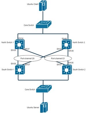

Introduction This article is part of a series on deploying BIG-IPs with bypass switches and network packet brokers. These devices allow for the transparent integration of network security tools with little to no network redesign and configuration change. For more information about bypass switch devices refer to https://en.wikipedia.org/wiki/Bypass_switch; for network packet brokers, refer to https://www.ixiacom.com/company/blog/network-packet-brokers-abcs-network-visibility and https://www.gigamon.com/campaigns/next-generation-network-packet-broker.html. The article series introduces network designs to forward traffic to the inline tools at layer 2 (L2). This article covers the design and implementation of the Gigamon Bypass Switch / Network Packet Broker in conjunction with the BIG-IP i5800 appliance and Virtual Wire (vWire) with LACP Mode. This article covers LACP Mode deployment mentioned in article https://devcentral.f5.com/s/articles/L2-Deployment-of-BIG-IP-with-Gigamon. Network Topology Below diagram is a representation of the actual lab network. This shows deployment of BIG-IP with Gigamon. Figure 1 - Topology with MLAG and LAG before deployment of Gigamon and BIG-IP Figure 2 - Topology with MLAG and LAG after deployment of Gigamon and BIG-IP Figure 3 - Connection between Gigamon and BIG-IP Hardware Specification Hardware used in this article are BIG-IP i5800 GigaVUE-HC1 Arista DCS-7010T-48 (all the four switches) Note: All the Interfaces/Ports are 1G speed Software Specification Software used in this article are BIG-IP 16.1.0 GigaVUE-OS 5.7.01 Arista 4.21.3F (North Switches) Arista 4.19.2F (South Switches) Switch Configuration Switch Configuration is same as previous article https://devcentral.f5.com/s/articles/BIG-IP-L2-V-Wire-LACP-Passthorugh-Deployment-with-Gigamon Note: In above mentioned configuration switch ports are configured as access port to allow vlan 120, so BIG-IP will receive untagged frames. In case to have tagged frame, configure switch ports as trunk ports. In this article, below scenarios are tested with Tagged frames. Gigamon Configuration Gigamon Configuration is same as previous article https://devcentral.f5.com/s/articles/BIG-IP-L2-vWire-LACP-Passthrough-Deployment-with-1-to-1-mapping-of-Gigamon-NPS BIG-IP Configuration BIG-IP configuration is exactly same as configuration mentioned in https://devcentral.f5.com/s/articles/L2-Deployment-of-BIG-IP-with-Gigamon This article is specific to LACP Mode, find below trunk configuration with LACP mode enabled. Figure 4 - Trunk configuration with LACP enabled Note: For LACP mode, in vWire configuration Propagate Virtual Wire Link Status should be disabled. Scenarios As per Figure 2 and 3, setup is completely up and functional. As LACP passthrough mode configured in BIG-IP, LACP frames will passthrough BIG-IP. LACP will be established between North and South Switches. ICMP traffic is used to represent network traffic from the north switches to the south switches. Scenario 1: Traffic flow through BIG-IP with North and South Switches configured in LACP active mode Above configurations shows that all the four switches are configured with LACP active mode. Figure 5 - MLAG and LAG status after deployment of BIG-IP and Gigamon with Switches configured in LACP AC TIVE mode Figure 5 shows that port-channels 120 and 121 are active at both North Switches and South Switches. Above configuration shows MLAG configured at North Switches and LAG configured at South Switches. Figure 6 - ICMP traffic flow from client to server through BIG-IP Figure 6 shows ICMP is reachable from client to server through BIG-IP. Here LACP is established between Switches and BIG-IP, whereas in passthrough mode LACP will be established between switches Figure 7 - Actor ID of BIG-IP Figure 8 - LACP neighbor details in switches Figure 7 and Figure 8 shows LACP is established between Switches and BIG-IP. Scenario 2: Traffic flow through BIG-IP with North and South Switches configured in LACP Passive mode North Switch 1: interface Ethernet36 channel-group 120 mode passive interface Ethernet37 channel-group 121 mode passive North Switch 2: interface Ethernet37 channel-group 120 mode passive interface Ethernet36 channel-group 121 mode passive South Switch 1: interface Ethernet36 channel-group 120 mode passive interface Ethernet37 channel-group 120 mode passive South Switch 2: interface Ethernet36 channel-group 121 mode passive interface Ethernet37 channel-group 121 mode passive Figure 9 - MLAG and LAG status after deployment of BIG-IP and Gigamon with Switches configured in LACP Passive mode Figure 9 shows that port-channels 120 and 121 are active at both North Switches and South Switches. Above configuration shows MLAG configured at North Switches and LAG configured at South Switches. Figure 10 - ICMP traffic flow from client to server through BIG-IP Figure 10 shows ICMP is reachable from client to server through BIG-IP. BIG-IP configured with LACP in Active mode and Switches configured with LACP in Passive mode, thus LACP got established successfully. This behavior will not occur when BIG-IP configured in Passthrough mode, in that case both the North and South will be in LACP passive mode and LACP will not get established. Scenario 3: Active BIG-IP link goes down in BIG-IP Figure 10 shows that interface 1.1 of BIG-IP is active incoming interface and interface 1.2 of BIG-IP is active outgoing interface. Disabling BIG-IP interface 1.1 will make active link down as below Figure 11 - BIG-IP interface 1.1 disabled Figure 12 - Trunk state after BIG-IP interface 1.1 disabled Figure 12 shows that all the trunks are up even though interface 1.1 is down. As per configuration, Left_Trunk1 has 2 interfaces connected to it 1.1 and 2.3 and one of the interface is still up, so Left_Trunk1 status is active. In previous article https://devcentral.f5.com/s/articles/BIG-IP-L2-V-Wire-LACP-Passthorugh-Deployment-with-Gigamon, individual trunks got configured and status of Left_Trunk1 was down. Figure 13 - MLAG and LAG status with interface 1.1 down Figure 13 shows that port-channels 120 and 121 are active at both North Switches and South Switches. This shows that switches are not aware of link failure and it is been handled by Gigamon configuration. Figure 14 - One of Inline Tool goes down after link failure Figure 14 shows Inline Tool which is connected to interface 1.1 of BIG-IP goes down. Figure 15 - Bypass enabled for specific flow Figure 15 shows tool failure introduced bypass for Inline-network pair Bypass1 ( Interface 1.1 and 1.2) If traffic hits interface 1.1 then Gigamon will send traffic directly to interface 1.2. This shows traffic bypassed BIG-IP. Figure 16 - ICMP traffic flow from client to server bypassing BIG-IP Figure 16 shows client is reaching server and no traffic passing through BIG-IP which means traffic bypassed BIG-IP. Figure 17 - Port Statistics of Gigamon Figure 17 shows traffic reaches interface 1.1 of Gigamon and forwards to interface 1.2. Traffic is not routed to tool, as specific Inline-Network enabled with bypass. In the same scenario, if traffic hits any other interface apart from interface 1.1 of Gigamon then traffic will be route to BIG-IP. Please note that only one Inline-network pair enables bypass, remaining 3 Inline-network pairs are still in normal forwarding state. Scenario 4: BIG-IP goes down and bypass enabled in Gigamon Figure 18 - All the BIG-IP interfaces disabled Figure 19 - Inline tool status after BIG-IP goes down Figure 19 shows that all the Inline Tool pair goes down once BIG-IP is down. Figure 20 - Bypass enabled in Gigamon Figure 20 shows bypass enabled in Gigamon and ensures there is no network failure. ICMP traffic still flows between ubuntu client and ubuntu server as below Figure 21 - ICMP traffic flow from client to server bypassing BIG-IP Conclusion This article covers BIG-IP L2 Virtual Wire LACP mode deployment with Gigamon. Gigamon configured with one to one mapping between Inline-network and Inline-tool. No Inline-network group and Inline-tool group configured in Gigamon. Observations of this deployment are as below As one to one mapping configured between Inline-network and Inline-tool, no additional tag inserted by Gigamon. As there is no additional tag in frames when reaching BIG-IP, this configuration works for both Tagged and Untagged packets. If any of the Inline Tool link goes down, Gigamon handles bypass. Switches will be still unware of the changes. If any of the Inline Tool Pairs goes down, then specific Inline-network enables bypass. If traffic hits bypass enabled Inline-network, then traffic will be bypassing BIG IP. If traffic hits Normal forward state Inline-Network, the traffic will be forwarded to BIG-IP. If BIG-IP goes down, Gigamon enables bypass and ensures there is no packet drop. Propagate Virtual Wire Link State should be disabled for LACP Mode in Virtual Wire Configuration881Views5likes0CommentsBIG-IP L2 Virtual Wire LACP Passthrough Deployment with Gigamon Network Packet Broker - II
