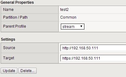

I basicly try to use the stream profile to replace the http:// string of my server side response data with https:// and just changed my custom stream profile as below :

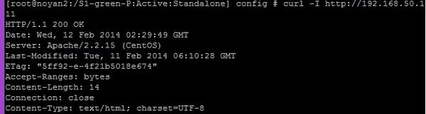

But though I simply click the http://192.168.50.111/ into my web browser, it just keeps load balancing and retrieves a pool member with a HTTP 200 OK code. Isn't it expected that it must show me https://192.168.50.111 instead of http?
In my research, it says if the web page returns 302, 303 or 307 status codes, we can see a Location Header which can show the replaced URL as https://blabla in the captured packets (collected with Wireshark) or sth else.
Is there any other configuration in F5 menu to apply the stream profile correctly? I want to only use the Stream Profile, not an iRule. However iRule didn't work either. I really don't know why. Here's the curl command result :

  • Hi,
    the Stream profile allows you the ability to search for a string within a data stream and replace that string with another string. In your case it searchs in data stream "http:\http://192.168.50.111/" and replace to https://192.168.50.111, not doing redirect. If you want to redirect from http to https you can use simple, iRule:

  • Thank you for the reply. In fact I don't want to do a redirection, just trying to work with Stream Profile itself but I still can't get to observe how is the correct usage and its effects.
    Well, if I write the source as just "http://" and the target is "https://" what will be effected and how can I test the output? Will there be a difference?
  • The STREAM profile doesn't really work well with URLs. It works on the data in both directions, so basically you're saying replace any http:// references with https:// on the way in (Host headers usually), and again replace any http:// references with https:// on the way out (Location headers and payload object references). So assuming you only want to replace content in one direction, you necessarily need to do STREAM in an iRule. Apply an empty STREAM profile to the VIP and an iRule like this:
