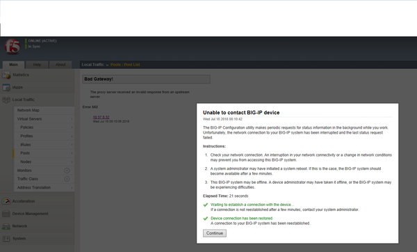

Bad gateway error 502 on statistic pages
Hey Guys,
We are getting this on one of our boxes. It only shows up in the statistics tabs in virtual servers and pools for now.
I tried restarting the httpd and tomcat but nothing.

Also did the pcap on the mgmt and it was all clean.
The version is 12.1.2 on the box and we see this both on active and standby boxes.
So, what you think??. .Thanks.

    • Davidfisher_345's avatar
      Davidfisher_345
      As I mentioned, the first thing we did was restart HTTPD and TOMCAT, but that did not fix it.
      Now f5 support has answered :
      The issue with the 503 errors observed while trying to view stats in the GUI might be related to the java process out of memory errors seen in the tomcat logs:
      /var/log/tomcat/catalina.out
      Exception in thread "Thread-2" java.lang.OutOfMemoryError: Java heap space Jul 15, 2018 2:55:33 PM org.apache.tomcat.util.threads.ThreadPool$ControlRunnable run
      SEVERE: Caught exception (java.lang.OutOfMemoryError: Java heap space) executing org.apache.jk.common.ChannelSocket$SocketAcceptor@189f044, terminating thread
          at java.util.Arrays.copyOf(Arrays.java:2367)
          at java.lang.AbstractStringBuilder.expandCapacity(AbstractStringBuilder.java:130)
          at java.lang.AbstractStringBuilder.ensureCapacityInternal(AbstractStringBuilder.java:114)
          at java.lang.AbstractStringBuilder.append(AbstractStringBuilder.java:415)
          at java.lang.StringBuilder.append(StringBuilder.java:132)
          at com.f5.mcp.io.ConnectionManager.run(ConnectionManager.java:267)
          at java.lang.Thread.run(Thread.java:744)
      com.f5.mcp.io.McpQueryException: Empty reply message
      Please follow the steps in the solution links below to provision additional memory to the tomcat process. I'd suggest you start with an extra 20MB and verify if the issue persists
