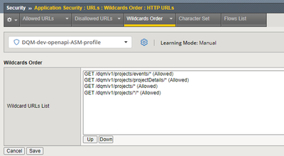

AWAF Path Parameters with OPENAPI json file
Hi,  Iam securing a API with a JSON OPENAPI file  it mostly works fine however I have two positional parameters used in one url that seems to mask the following paths "/dqm/v1/projects/{customerId}/{pageNumber}  & /dqm/v1/projects/projectDetails/{workRequestId}" The result is illegal parameter length violations on a url that is actually valid. the two paths have different operationId headers associated with them Does the WAF use the operationId to match the Path? It appears not as if I delete the operation Id from the api file then the policy matches the correct URL.
Any assistance in ubderstanding what is happening and why is appreaciated.

  • The resolution to this issue is to use the WildCards Order TAB to set the order the URLS should be processed.

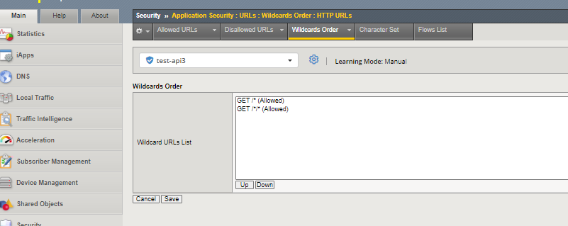

      • Chris_Thuys's avatar
        Chris_Thuys
        Sometimes it's all about the keywords you search on. Mine were all wrong. I was focused on the jSON  file rather than the Wildcard URL's.
  • By the way ChrisThuys / Chris_Thuys  I seem to found a workaround as for example if you create the policy from the start like the one below it will result in the following order but you need to create asm policy from the start with the correct order as if you modify the openapi/swagger file it may not change the order.
    Outside of that I am trying to use positional parameters as to trigger wildcard url match and still figuring out if wildcard parameter names are supported by F5 AWAF/ASM when importing a swagger/openapi file. I do not know if you have tried this as well.
