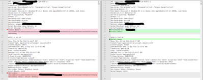

We're having issues when enabling ASM on the virtual server serving the Cisco Meeting Server WebRTC application. Te problem is that the users are unable to join meetings as soon as we enable ASM on the VS. we have tried to attach the ASM policy with everything possible disabled and in transparent mode, but the issue still remains.
What we have notice when comparing traffic with ASM enabled and disabled is in case when ASM is enabled, that the cookies sent from client are not passed to the server.
Below is diff betwen the client side request (left) and the servers side (right) when ASM is enabled.
Therefore, we suspect something must be related to the cookies.
Does anyone have any idea what could cause this? the BIG-IP version is v15.1.8.1 (Build 0.0.3).

I think you might be reading this information wrong. By design, the F5 WAF engine injects a new cookie in the client-side connection, and uses it to correlate client events within a session and to check data integrity.So, the behavior you're seeing in the capture is correct. The full server-response that you're receiving is being forwarded as-is to the client (well, it does strip the nginx information), and the WAF uses the set-cookie attribute to create a hash for this session.
Consequent client requests to the WAF will include this hashed cookie, and since the server doesn't require to see it, it's not being forwarded.
I'm not seeing missing informations from the logs you attached. Let me know if this is clear enough!
