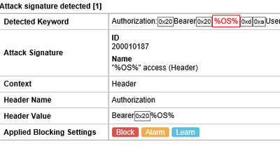

      thank you so much, looks like we are almost there but still not working. is it because above provided irule ONLY expecting attack signature violation but there is also "Modified domain cookie" detection. However modified cookie is in ALARM mode. so should further modification needed? please see below screenshots
      • f5learner's avatar
        f5learner
        please let me know if you need furhter inforamtion, thank you so much for your assistance
      f5learner
      Thank you for your help
      by changing to CONTAINS allowed bypass for other violations in Blocking mode as well, for example I blacklisted my source IP but the request was allowed so that should not happen
