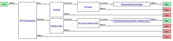

I have APM setup as Idp with Service-Now as SP with Kerberos and basic auth setup. It is working as expected (except for SLO but that's another story). I'm running 11.4.1 HF7. We recently merged with a different company which of course has a different AD domain name. Because of some special requirements I can't just setup cross domain auth. So lets say I have us.example.com (my original domain) and now them.example.com. All the users in them.example.com actually have userid's in us.example.com but they use their them.example.com userids to login by default. So when they hit the service-now URL, kerberos auth fails and a login box pops up asking for credentials. If the uesr simply puts in us.example.com\userid, authentication will succeed, but the users cannot be expected to know that. So I am trying to find a way to rewrite the domain from d2.example.com to ds1.example.com. It is acceptable for the login box to up, they just want to enter their us.example.com userid without the domain portion.
Here is the current Access policy:
I use the "AD Query Kerberos Auth" to get the userPrincipalName=%{session.logon.last.username} so I can use %{session.ad.last.attr.sAMAccountName} in the SAML assertion.

what about modifying the domain session variable between the basic line and the AD auth to force the value ?
