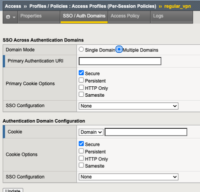

Upon the first network request without a cookie, APM creates a session ID and sends it to the client in an "MRHSession" cookie. Upon each subsequent network request, the client should transmit this cookie and to tie the request to the user's session. It sounds like for whatever reason, your login session isn't following this pattern.
To see why, use your browser's dev tools to examine the cookies sent and recieved by your user's browser. It might be that you're using multi-domain mode (when you visit a host with no MRHSession cookie, the APM will redirect you to the "Primary Authentication URI" for login, then redirect back to the original URI and use some HTTP redirect tricks to share the MRHSession cookie between the domains specified in the config). This is where that multi-domain mode is set up:
