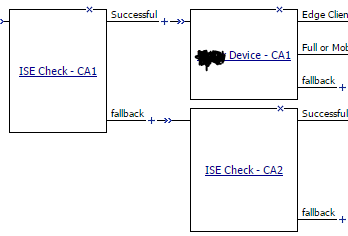

In my AP right now, I have a machine cert inspection. I have it set to only look for one issuer right now. I would like for it to check from two different issuers. Is there a way to do this in one...

Apr 07, 2016You will need to check for one issuer then fallback to the other issuer if the first check doesn't pass. You will not be able to do an "OR" statement in the issuer.
You can use a regex if you would like. The following is from the online help for the Machine Cert Action.
Specifies a regular expression to use to match the Issuer content against the specified pattern.
The order of RDNs is the same as is displayed; the required separator is a comma ,.
Example 3. Regex extraction
Partial match. CN=.*, OU=FP, O=F5, L=San Jose, S=CA, C=US
Exact match. [email protected], CN=f5clientrootcert, OU=es, O=f5, L=london, S=chertsey, C=uk
You could have something like
CN=CA.*, DC=ABC, DC=COM and that should match CA1 and CA2.
