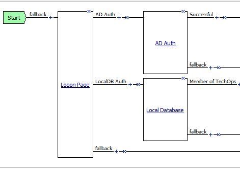

I played a bit and set up logic like this, but wasn't able to get LocalDB authentication to work (yet):

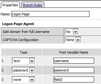

How did you define the branch rule named "LocalDB Auth" from the Logon Page? - Stanislas_Piro2

Thanks for your quick responses. Sorry I didn't include the Login Page details! It's the default Login Page configuration, and I just added a second branch rule to try to add on the LocalDB authentication:

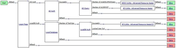

Here's the full picture of the logic tree:

OK, I think I understand the confusion here. APM, does not "fall back to a previous branch" in the case of failure. It only moves forward. I'm actually surprised that AD auth even works because you have not process AD auth yet for the expression "Active Directory Auth has Passed". You need to use branch rules for the information that you have at hand. I expect that would would need to swap LocalDB auth to the fallback branch of AD Auth to achieve your expected outcome. You can than also use a single fallback branch off the logon page. The logon page can't really fail since it only displays a page to the user. You would use branch rules on the logon page if you wanted to make a preemptive decision for AD/LocalDB based on the userid that was entered.
I hope this clears up the confusion.
- Stanislas_Piro2
Cumulonimbus
your configuration is wrong...
The branch expression must be based on information you have --> username.
the two first branches will never match because AD Auth and Local DB Auth are not yet evaluated...
you must create expression with username. like expr { [mcget {session.logon.last.username}] starts_with "ext-" } linked to LocalDB.
The fallback branch linked to AD Auth..
with this configuration, create local DB users with "ext-" prefix
- DFeike_160744
or if you want a true fallback, disable the branch on the logon page and then decide to either check AD first with the appropiate steps needed and on the the AD Auth action set up the check for local DB on the fallback branch there. vice versa if you want to check for local DB first.
Hope that helps :)
