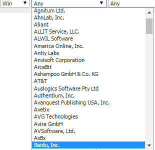

I'm suprised to not see AVAST antivirus in the list of Vendor ID supported for antivirus Check in APM

I checked in my APM v13 and AVAST is not in vendors list but Avast products are in Products list.
Can you upload manually the last file, try again with "Any" and check in logs if Avast is found?
