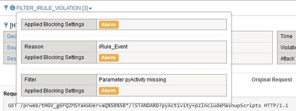

  • I just built it.
    Now I also get an Arlam when calling the page with the parameter.
