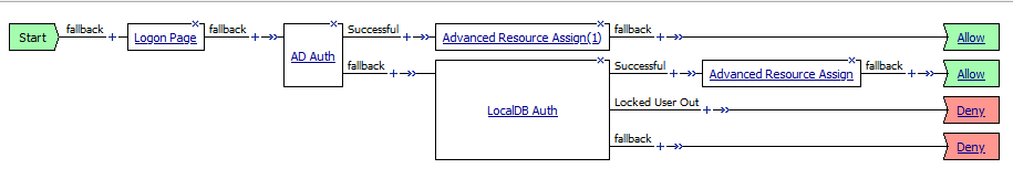

Here is my structure.
I found that I can successfully log in with my AD account without any problems!
However, when I try to log in using a local database account, sometimes it works and sometimes it doesn't...
I'm not sure if I'm having problems with my schema.
Any Help is appreciate.

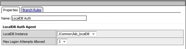

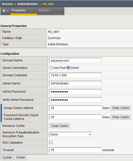

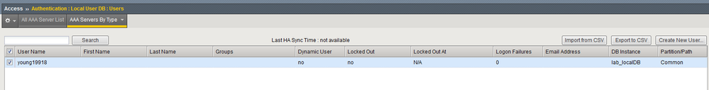

      Here is my AD Auth and LocalDB auth Setting
      When I login with local DB account, it fails.
      I realized that F5 didn't go through the Local DB authentication process after it thought my AD authentication failed...
